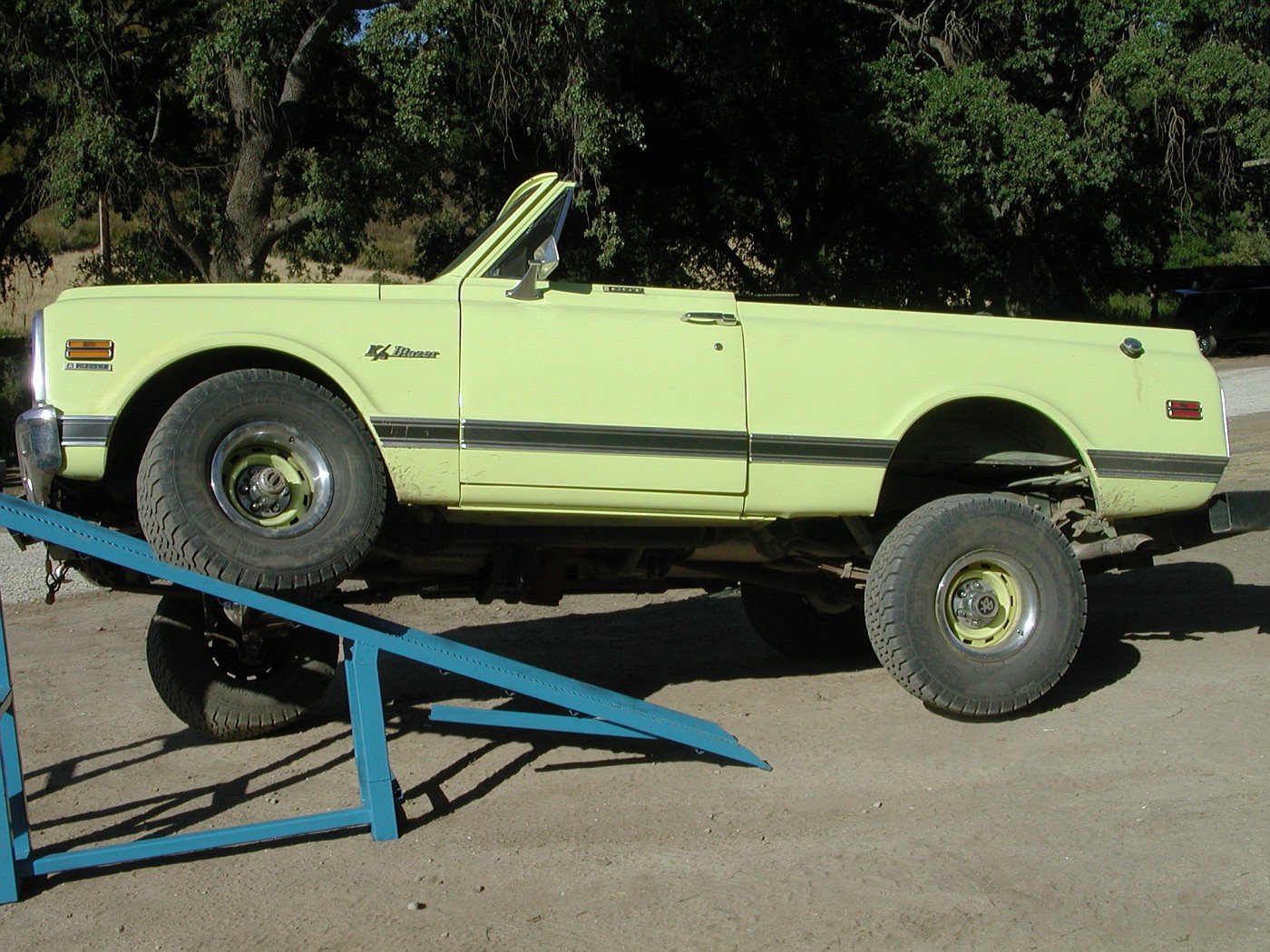

On my 71 I have stock suspension(no body or suspension lift),2nd gen 8" factory ralley rims and 33x12.5"x15" All Terrain Radials.
I've flexed my Blazer as much as my stock suspension will allow and I have NEVER had any tire rub.
