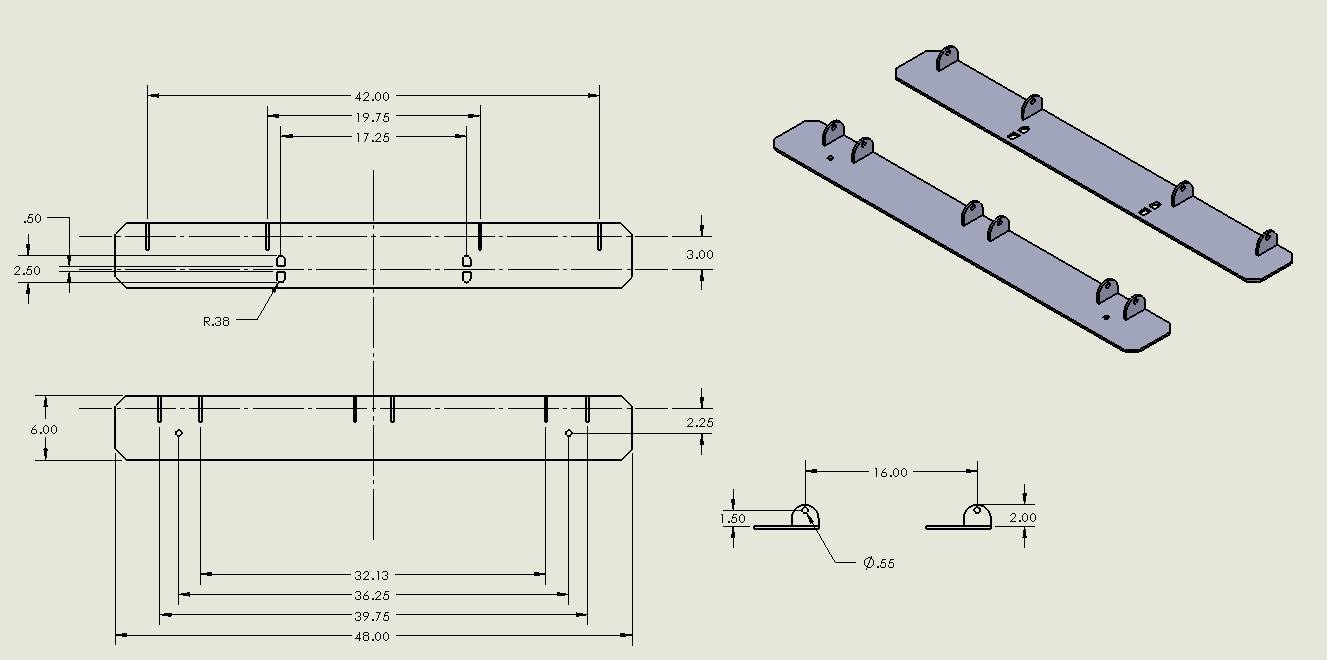

Once upon a time on a different forum, a guy posted these seat mount plans before Merrick started selling his. These plans were free to anyone that wanted them, the MG bracket looks very similar. :whistle:

I agree with all of that. I'm literally estimating $100 in steel shipped and 5 hours of fab time (for an avg joe like myself). Merrick's are $600 shipped (raw steel w/o powder coating). So assuming $100 in shipped mats, that comes to $100/hr for my time. Only after doing that math I decided to fab this myself instead of buying from Merrick, who I think is an awesome guy that sells great products and I don't think he's overpriced at all. It's just that I have all the tools and I'm confident I have the skills to fab something simple like this myself.

Those plans omit 2, .5" dia x 48" solid rods, correct?
Steel Supply LP out of TX looks legit to me and AFAICT has great prices. I'm going to get 6"X120" cut at 48" twice (0.125" thick), 2"X48" (0.125" thick) and 2, 0.5"X48" solid rods for $61 plus $35 shipping to FL, $103 total with tax. By looking at those plans thats all the steel I'll need.
