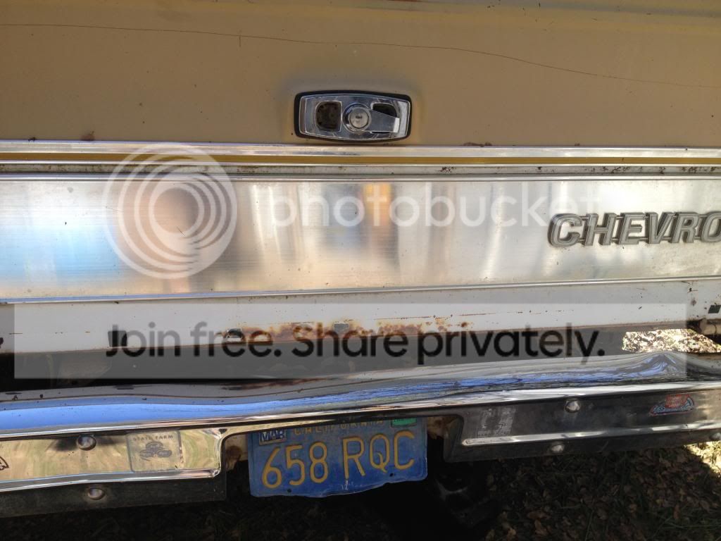

The body is in pretty good shape, only rust is on the roof and a bit on the tailgate.
This was the only part that really bothered me..:doah:
That's real nice right there.
