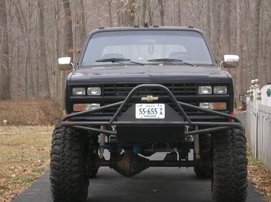

I decided to try my hand at building a winch bumper. I have some experience welding but am more of a grinder! First time using flux core wire also so the welds are a little ugly but the bedliner paint helps hide that for me. Let me know what you think. I am planning on adding a brush guard of sorts later just not sure which style.
3 x 5 angle for the mounts. I slid them back as far as I could over the frame. Going over the frame, instead of inside the frame channel, the 3 x 5 angle fit about as perfect as I could get.
Pretty good other than that fugly license plate
Come on now! That's custom too. I might try some sort of recessed mount for that when I do the brush guard. Until then Jersey requires a front plate so if I want to get it to the woods I have to put it somewhere.

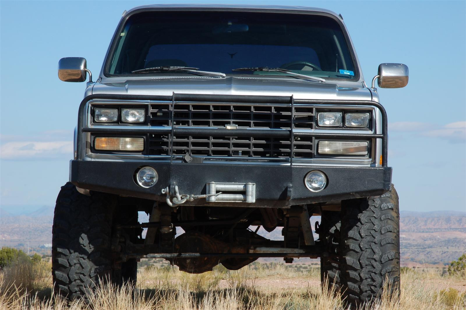

Nice, here's a couple of brush guards, for me I really like the stinger style and classic square looking brush guards:
I was talking about the black stripe. Looks terrible
Yeah I know what you were talking about. That is why I said it was custom too. I thought it was a good match though.
I think I am leaning toward the custom square style I think. Not much of a fan of the stinger and I don't think it goes well with what I started either. Thanks for the pics. Always good to have more references.
