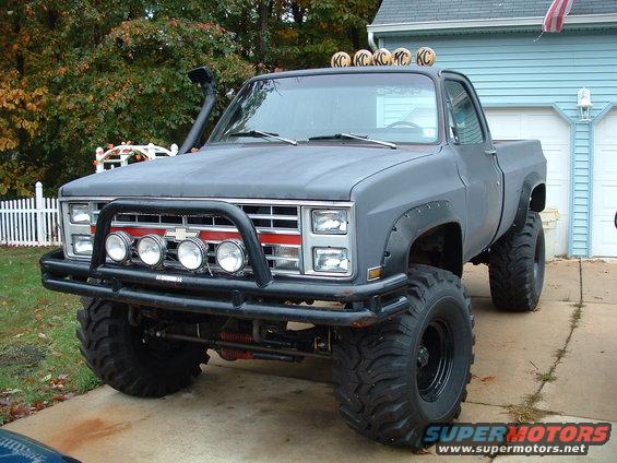

wow no one told ya... yeah there are some out there.... hard to find as they are old school... i personally like them alot... but with the new baha bumpers and road armor bumpers.... seems hidden isnt around anymore..
you could do what im doing... just go buy metal and fab one up...
i have a ramsey patriot 15,000lb winch between my rear frame rails...
and going to do a hydraulic up front hopefully soon!!!!
few pics of rear....
12" wide C channel... 3/8 i think... and 35" long... cut flat on end and mounted to frame....
not perfect.. im gonna grind an cleanup the weld.. then paint....
i have to work on the hitch too.. got it at a yardsale for $30... so gonna unbolt, grind welds and move that puppy up to the bottom of the bumper...
but you can see the winch fairlead...
now im gonna do the same thing to the front of the truck... weld roller fairlead in the front bumper too...
