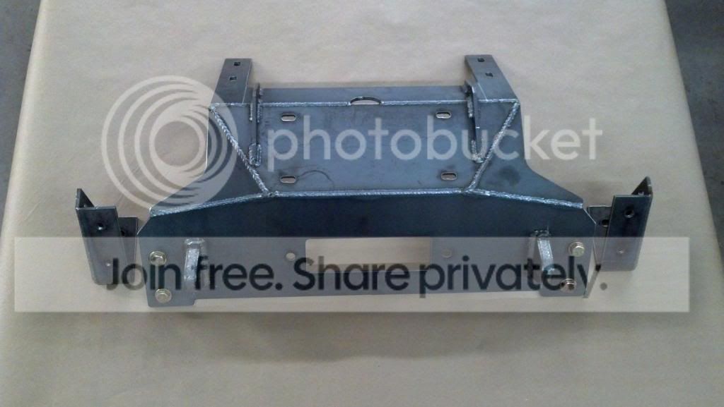

TNA's winch mount.
That's sweet, but keep in mind you probably can't run the stock bumper with it.

The TNA mount pictured is the one I won at BB. Have not put it on. Being a fabricator myself, I would not build it any different.

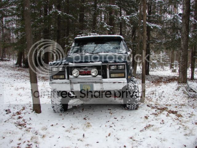

Mine is on a converted jeep mount on a receiver hitch that's behind the bumper. I've pulled the front wheels off of the ground with it. Slid the truck sideways up hill with the hook on a back d ring. Never had an issue.
Even drove the winch into a tree to save the front sheet metal. It's a custom bolt in.

i'd kinda like to see that. i like the idea of hiding the winch behind a stock bumper.
