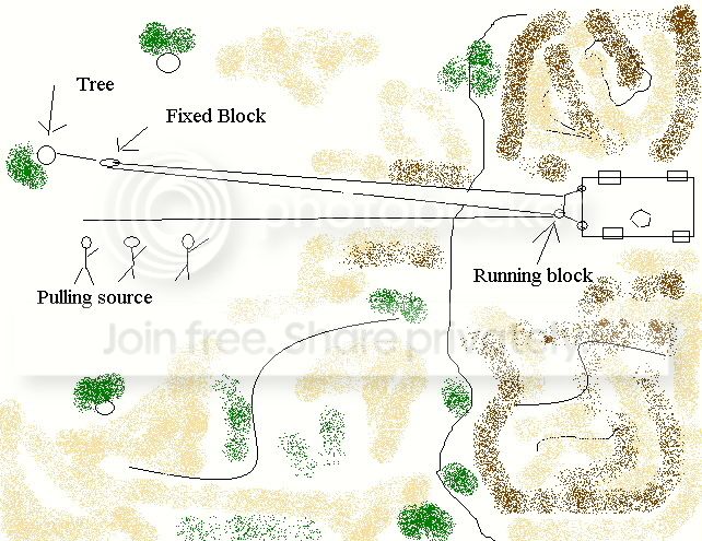

ok so heres the scene. this weekend i need to pull a school bus out of the bushes were it has been sitting for about 5 years sunk to the axles front and back . i have a 12000lb warn on the front of cucv. now for the question ? i have a three part block and tackle with 10,000lb rope in . to dead hook the b&t to some thing pull the free end with winch it will increase the pulling power . but will it take alot of strain off the rope as well . i know to snatch block will double but does that take strain off the cable . i guess i am asking if the rope will take it .i guess i am tring to say is will the rope and calble rating increase as well as pulling power .
The tension in the cable will never be higher than the maximum pull rating of the winch. Using a snatch block will double your pulling force, but the max tension stays the same (ignoring friction from the snatch block). So, your cable should be fine unless it is damaged.

I made a great post a while back dealing with this situation. Click on link above and read the post.

I believe he is saying that he has a block and tackle with it's own rope (think lifting hay in the barn) and he wants to know if he can use the winch to pull on the end of the rope you would pull on with your hands. The block and tackle sounds like it has a safe limit of 10,000lb. A 12k warn will outpull that already. What you want is a snatch block rated for use with a 12k winch.

Metrodps has the idea of what i want to do dead hook the b&t pull it with winch .I have seen the sites you guys have posted look at them thanks great ideas. I also read a while back when Metrodps posted his info thats were i get al these crazy ideas from . well i am going to try . it will be fun lots of cooooold beeeer as well .
