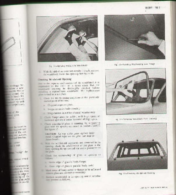

The is the 1973 GM Service manual for removing the self-locking strips. Great isn't it. Don't forget to tape those rags to your shoes!
you want the gasket nice and warm. use lots of soap and water. all the glass guys i know use blue dawn dish soap works best. and some mix blue washer fluid with it for more slide. then use a plastic blade of some sort and work the soap/water under the gasket and glass. then take a corner and try to pop it out and work out from there. the stip is much easyer than non strip one. thay seel a tool to install strip easy.
