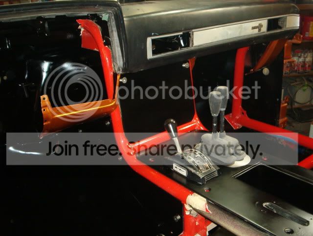

It's much more compact without the plastic housing and pretty easy to mount. The trick is figuring out the cable routing. But either way, it doesn't need to take up near that much space. I mounted mine off the side of the Tuffy console.

Any chance you've got a photo of what that shifter looks like without the big plastic cover on it?

Best I've got:
