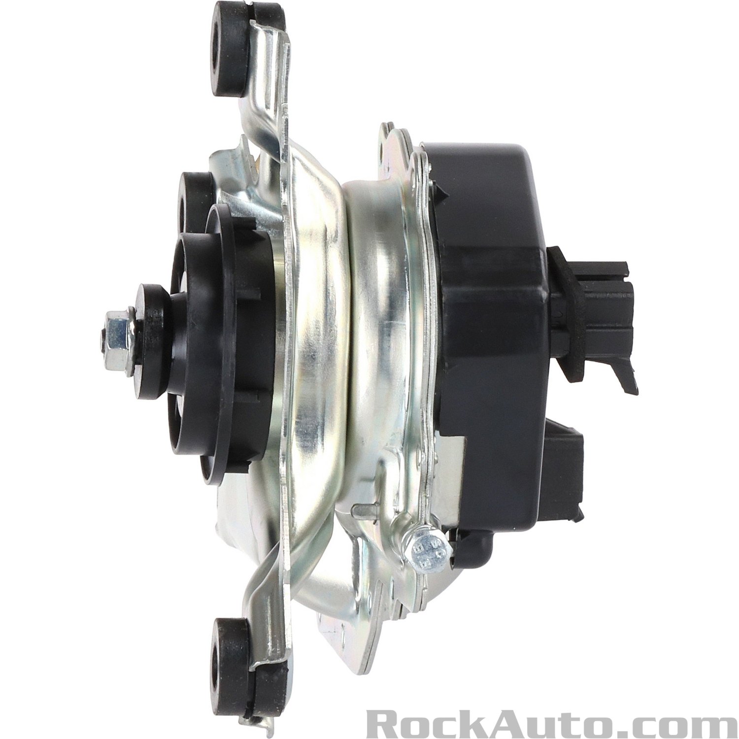

Don't think they have a circuit board. The connector on the right is power (Hi/Lo), which just makes the motor turn. The linkage creates the back-and-forth motion. The left connector is the park switch. The circuit board for delay wipers is mounted under the column.
Sorry, That doesn't look a thing like the wiper motors that I have repaired. I haven't looked in a while, but it seems that the one that I'm thinking of is blockier looking. I went back to the original post by TommyD and I guess that I'm reading it wrong. I thought that he was having problems with the motor on his 91 K5. I guess that must be the one from the 84 K2500. Sorry for the mistake. I'm glad that you corrected me because I've been looking for the repaired board that I had/have to send him. One thing about it, I found some other stuff that I'd looked for some time ago.
