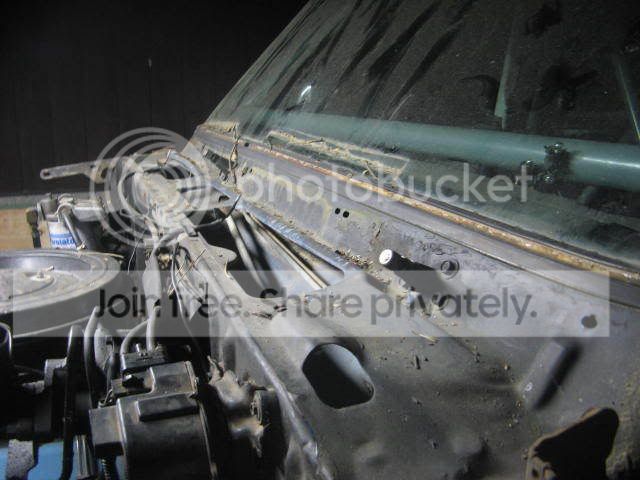

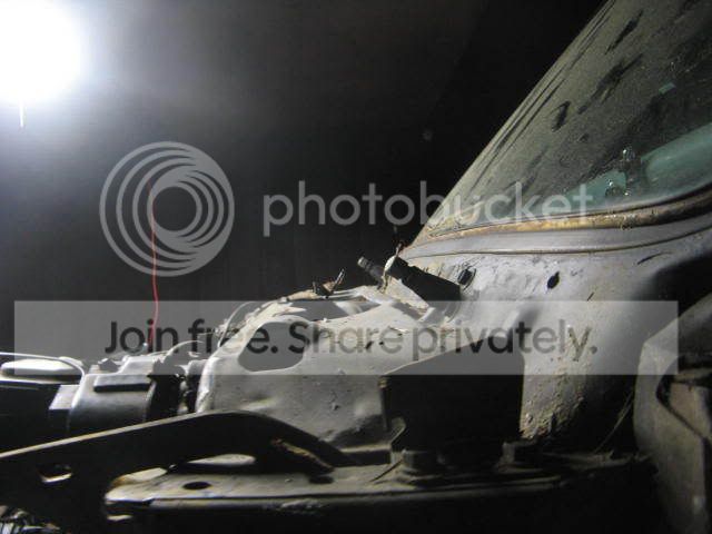

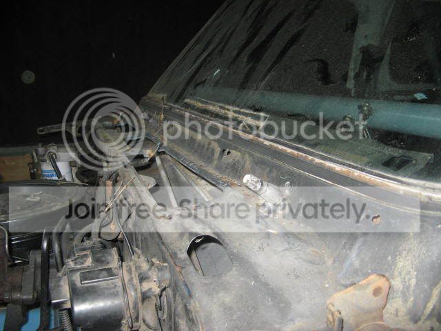

OK, snapped three quick ones...gonna add a couple of pics of Aaron's for comparison.
Dremu's '74
My '81
I don't see the cowl being different enough or higher or anything. At this point it doesn't appear that there'd be any hood interference...
It does appear the wiper nubs are pretty close in location, but the earlier nubs seem shorter. I think if the early wiper nubs were swapped this'd be do-able.
Of course I won't know for sure until I start bolting the sheet metal up though...
Rene
Holy big pics batman. But, seriously that is what I am seeing. The angle looks to be about right, and they just appear to be longer nubs to go through the cowl. Probably a difference in the bolt pattern as well, but nothing that a little cutting can't fix.
Yeah, i noticed but forgot to mention it. Should be relatively easy to swap to the shorter nubs... (just gotta source a set now...)
