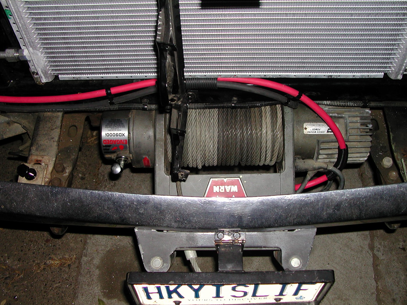

I used 2g welding cable.connected right to the battery from the winch.

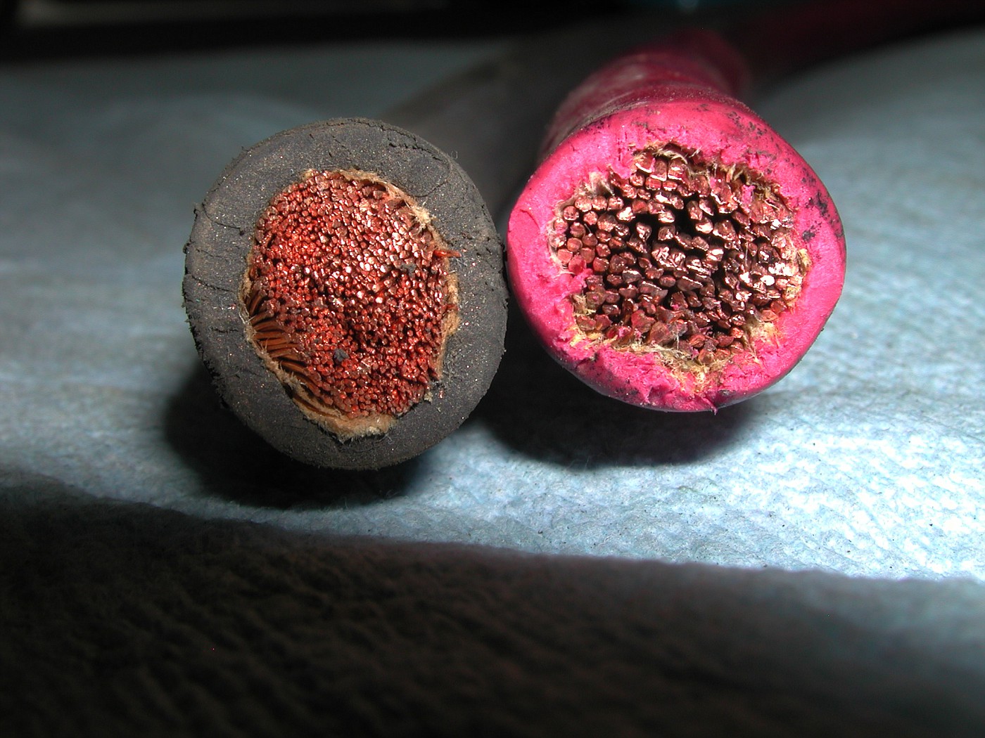

Here is a cross section of the orig. winch wire(red one) and the 2g welding wire.
Really, the correct wire size depends on what winch you have and how long a run the wires make. I have a 8000 lb Ramsey that came with 4 guage and a Warn HS9500 that came with 2 guage. Both sets of cables are only about 3' long. If I was to have to replace the wires, I'd err to the side of overkill. That said, I've got 50' or so of 2/0 laying around that I'd use since I already have it. Unless you have to use really long cables, I think 0 guage would support pretty much any winch out there.
I run a ramsey re10k worm gear winch. My battery is in back. I use 00 gauge copper.
