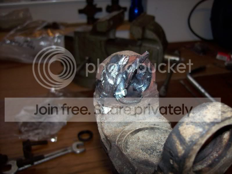

After I threw my driveshaft, this is what my yoke looks like. I don't think it's bent, just alittle tore up on the end. Should I reuse it or just replace it?

I am assuming you are trying to beat it in?
if so.. try grinding down the cap from the inside...
then place a socket on the inside (forget what size but use one as it fits perfect)
and beat on the yoke... then it should push outwards.... also plenty of lube.....
Alright, I was just about to bust out the grinder and start grinding on it, I'm just afraid to mess the yoke up worse.

Aw, well in the process of lubing, heating, and beating on the cap to get it out, right where the yoke is all chewed up cracked all the way through.
Can yokes be bought at auto parts stores? Do all NP208s have the same yoke?

go to a driveshaft shop and get a new one along with any other yokes you may have messed up. they also have the joints you need and will most likely give you advice.
