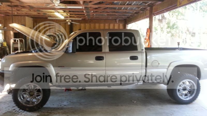

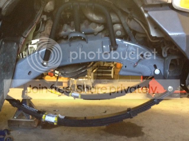

I have a chance to get this for a pretty good deal, I'm thinking about doing a SAS with leaves if I get it

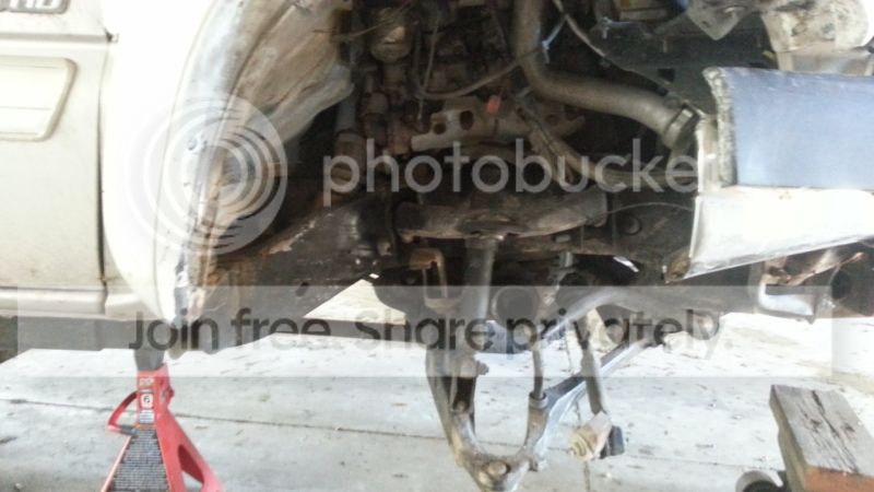

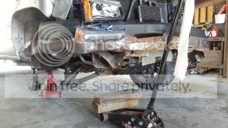

The frame is bent at the back of the upper a-arm mount, but doesn't seem like its too bad
Has 140k, tranny just rebuilt, 2700 in parts. Loaded, black leather in great shape, exhaust, intake, air dog, efi live
What do you guys think it's worth
Maybe I'll try to bend it back but I think with the leaves it should be fine

Heck cut all the independent stuff off, pull its straight if needed, the build a large plate for it. Maybe?
Yeah, thats kind of what I was thinking, pull it straight as best as possible and plate it with 1/8 or 3/16

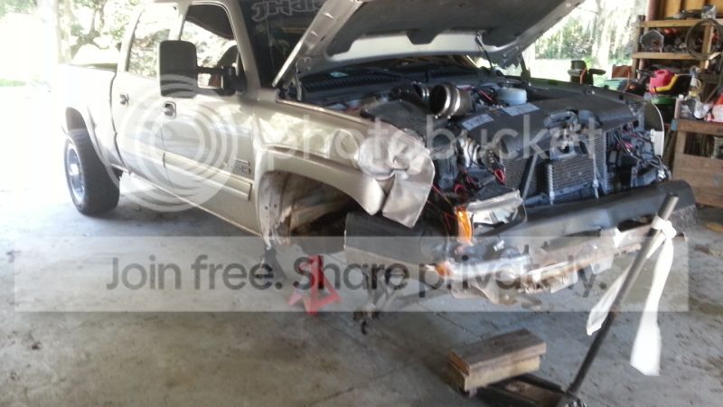

I went over and looked at it, the doors open fine, besides the passenger front, but that is just because the fender hits it.
I don't think the alignment will be that bad for a DD, I looked at it from the front and as far as I can tell the front frame at the hooks isn't tweaked at all. I didn't hit the frame on the front, missed and basically just used the a-arm as a lever. Thats why I'm thinking the frame is pretty square
I'm going back over to look at it, I'll try to get some measurements to see if everything is square
Airbags went off, but I already have the airbag for the drivers side NOS

Looks like the rear shackle hanger is a good bit behind where it's bent

little time on a an EZ-liner and it'd be fine more than likely... I pulled rails WAY more waffled than that..

Looked at it again today, I think it's bent less than an 1"
