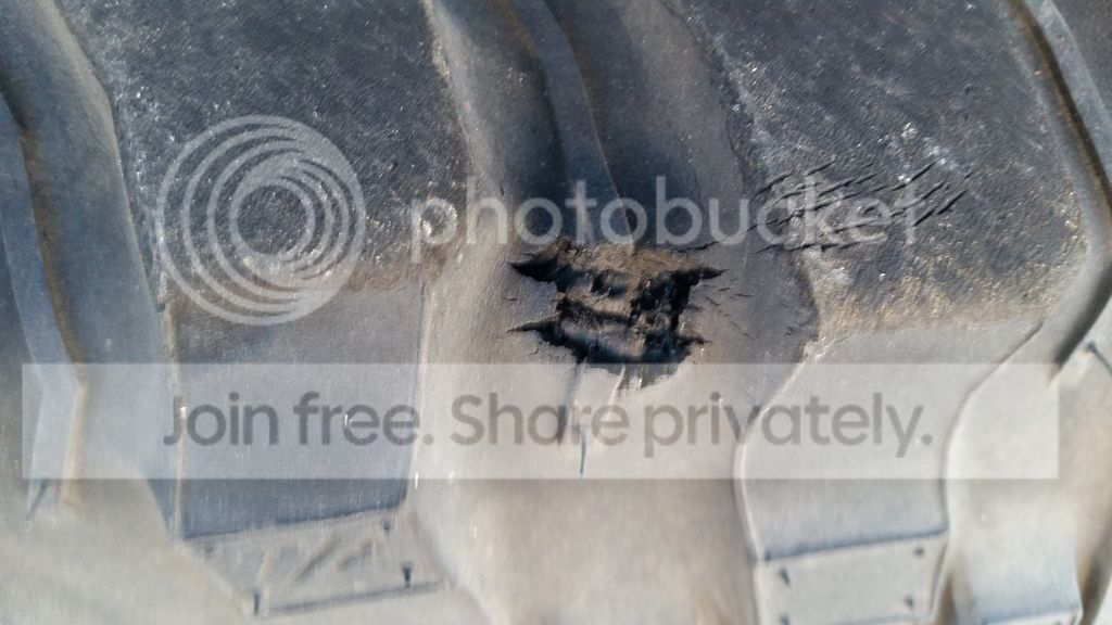

My k5 has been more or less immobile for the past 6 years. I start it up every two weeks to move it to the other sidr of the street for street cleaning. Literally, I've put 10 miles on it in that time. It's got a set of BFG Mud Terrains on it with about 5000 miles on them, that I bought and installed brand new. The other day I noticed this on my front drivers side tire.
[/URL][/IMG]
What is going on here? It looks like a blown out butt hole. What would cause this?
Any chance this is a warranty issue?
Looks like the start of tread separation. It may be under warranty, but either way it's unrepairable and I wouldn't drive around the block on it. Hopefully you can get them to warranty it for you.
Yeah that sucks man . Who Installed em,did you get a road hazard warranty?
Good luck considering that tire is obsolete now. You're gonna be looking at a whole new set to keep them matching.

Looks like dry rotish tire separation. The 5000 miles in what 1-2 years? Your saying 6 years sitting and who knows how old those tires were when you bought them. So lets just add 1 more year from production and distribution to installation, So at least 8-9 yr old tires, I know on my trailer and my RV you don't run a tire more than 5 years due to the lack of use and it sitting on one spot for longer duration's as well as weathered from sun. That spot could of been just something toxic/corrosive on the street one time or it could of been a blem on the tire itself? No way to tell for sure. If your only moving it for street sweeping I would not worry and just watch it. If your not driving it at all I would suggest not buying such a nice tire next time to save some coin. You could try the warranty thing but with this much time lapsed you better have your receipt and proof of those non miles used.

Thanks for all the replies. I have a matching spare I can put on if that one fails. In the mean time, I'll contact BFG and see what they have to say.
The tires should have a date code on them, if you really wanna know how old they are. :dunno:
My last set of BFG AT's started to exhibit tiny cracks at the base of the tread blocks which I noticed at about 8 years, which leaked air very, very slowly, but nothing like what is pictured.
