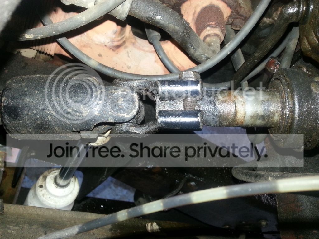

As promised:D
An xj shaft on my K30 , this is the bolt that will hit the column with out a notch

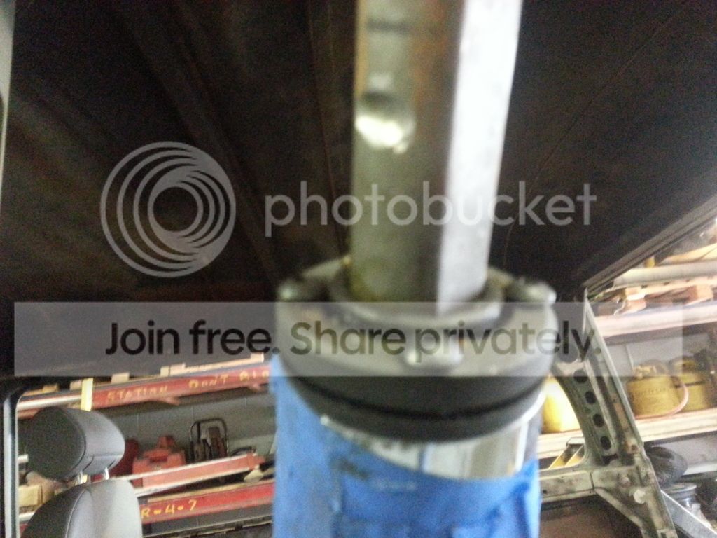

This is another column that has been notched for an xj shaft.
IIRC I used a dremel to do the notches, you dont need to remove a lot of metal, just enough to get the bolt in.
