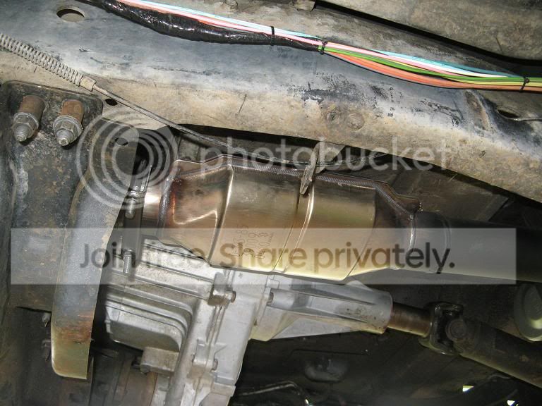

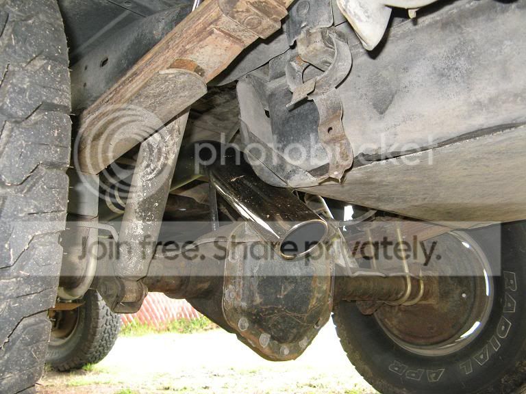

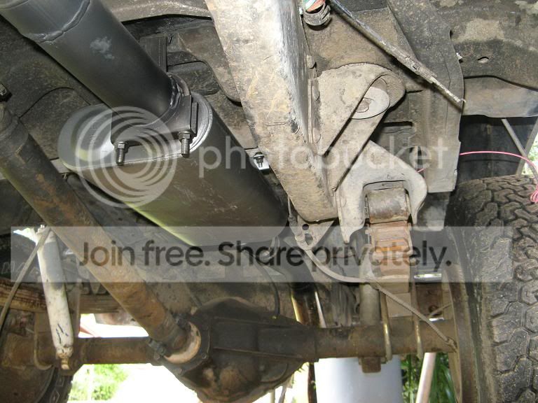

So happy. Came out real nice, just need to check on heat riser cause it's super close to the frame, even after tweaking. Guy had a used tip sitting on the ground, threw that on the end for a little bling. :)
very nice, mine goes into the shop tomorrow. hope it turns out as nice as yours...
Very nice, one of the best Single Exhausts ive seen. The "cross over" is always the tricky part.

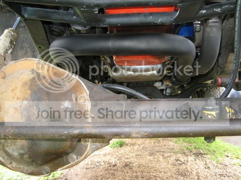

bout 3/8-1/2" at it's closest point, I plan to ceramic coat the y pipe portion of the exhaust in the near future. Just need to find a place local.
yep, I have an oil filter relocation kit that will be going in :)

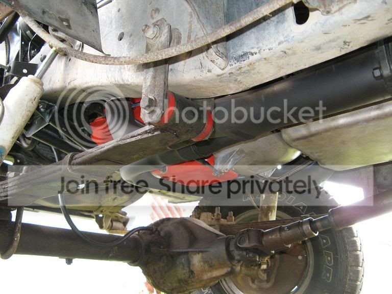

and the drive shaft kinda looks short, but the truck is only lifted 2-2.5".
You might have to ceramic coat/wrap the pipe as close to the pan as it is. The oil gets hot enough as it is without help from the exhaust.
if I did anything more than coating, I'd probably apply something to the pan right in that spot. Maybe a patch of something, to reflex and insulate from the heat. I don't like wrap very much, though I have a full roll in the garage.
Once I'm running the truck some more and working the bugs out, this stuff will get straightened out. I still need to drop the oil pan again, swap oil pumps and seal the pan better. Also need to put the filter remote mount on. As of today, I've only got about 17 miles on the truck since the engine went in and exhaust work done. :)
I'm guessing between the lift and the ORD crossmember you gained the clearance. I would maybe check into just wrapping the exhaust? Its like a band aid to fix the wound but maybe a combo of wrap and jet-hot coating?
You could weld a shield to the bottom of the pan or pipe. Like the way chevy starters have the built in heat shield on some of them.
i would not run my pipe that close or even un coated/wraped/shielded in the engine or tranny pan area. way to much heat transfer if you ask me.
