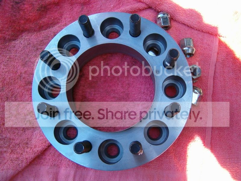

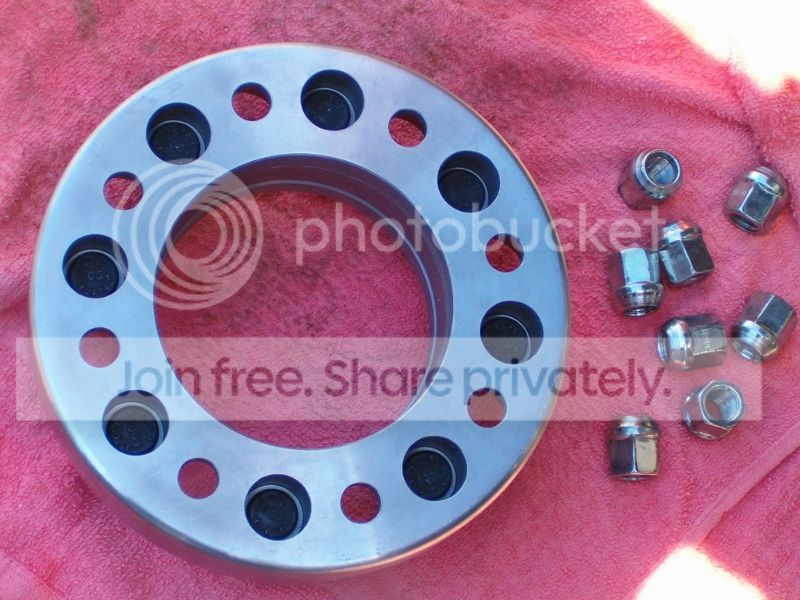

I used Freds' adapters....
http://www.wheeladapter.com/fred_goeske.php
Dam nice product...first rate!
He can custom make them any size you want!
The product looks great but holy Cr$p $370 a pair!! No way can I drop $740 on wheel spacers! Any other cheaper alternatives? I might have to rethink my wheel choice lol

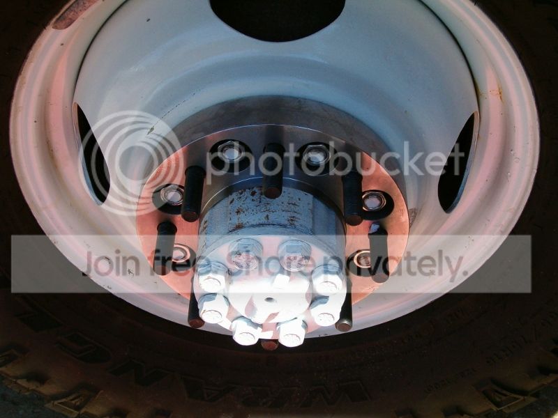

How much of a spacer is required to clear the 3/4 ton brakes and backing plate?
wouldnt that put excess load on the wheel bearings?
The leverage (excess load) on the wheel bearing is determined based on the location of the wheel centerline.
H1 Hummer wheels have 7" backspacing. If you install a 2" spacer it's the equivalent of running any other wheel with only 5" backspacing as the wheel centerline is now at the same location between them. So no, running spacers (reasonable 2"-3" width) on stock H1 Hummer wheels put no more leverage on the bearings than the "normal" wheels with around 4-5" backspacing.
