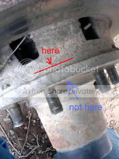

Yep, there it is. Press the studs out and you'll soon find out that the rotor seperates from the hub. I can see the parting line in the pics even. :rolleyes:
No you cant its 1 FOCKIN piece we allready pulled it off. the only thing you might be mistaken as a separation line is the ridge the hub hole of the wheel rides on.
No use in arguing with you. ANYONE on this site will tell you there is a rotor and a hub that are separate pieces. Have you pressed the studs out and tapped on the hub so that the rotor falls off. If you were closer i would be more than happy to prove you wrong.
Here's a better idea, why don't you go to the parts store and tell them that you need a new one piece hub/rotor assembly for an 83 and see if they have a listing.

Maybe I am wrong but I just do not see where they would come appart.
the hub steps up for the rim to ride on then curves right into the rotor there is no separation.
Wrong again, the rotors mount to the back side of the hub and the wheel studs go through the rotor and then press into the hub to hold the rotors to the hub.

AHHH hell man Im sorry I see it now. In the pic below. But you could have told me that rather than telling me I need a 4wd and what I have is a 2wd. It would have saved a lot of arguing. The implication that I was dealing with a 2wd rotor is what set me off. So once again I am sorry.

Yes, they separate at the red line you have there. I also only said you must have a 2WD rotor since the hub/rotor ARE one piece on those and i did not even look at what your vehicle was.
Five hours ago you were very adamant that yours were one piece, now "maybe you're wrong". Which is it?
I was upset that you made it out to seam like I dont know the differnce between a 2wd and a 4wd. You didnt make yourself very clear, other than just telling me I was wrong. NO explaination just wrong and telling me I need a 4wd rotor not a 2wd rotor. I may have been wrong about the rotor hub but I think you can agree its not a 2wd as you sugested.
It's absolutely not a 2WD. My argument came when you said you had a one piece hub/rotor from a 4WD.

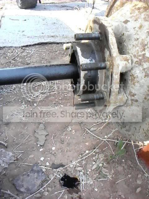

Pressed on drums.
Hmmm never seen a drum pressed on but then again my 14b is a custom frankenstein.
Could someone throw up a couple more pictures of pressed on drums just so when i do have to deal with them I'm not scratching my head.
Here you can see the hub and drum still together
Here is the hub without the drum
Here is the inside of the drum with the heads of the studs and the back side of the hub.
