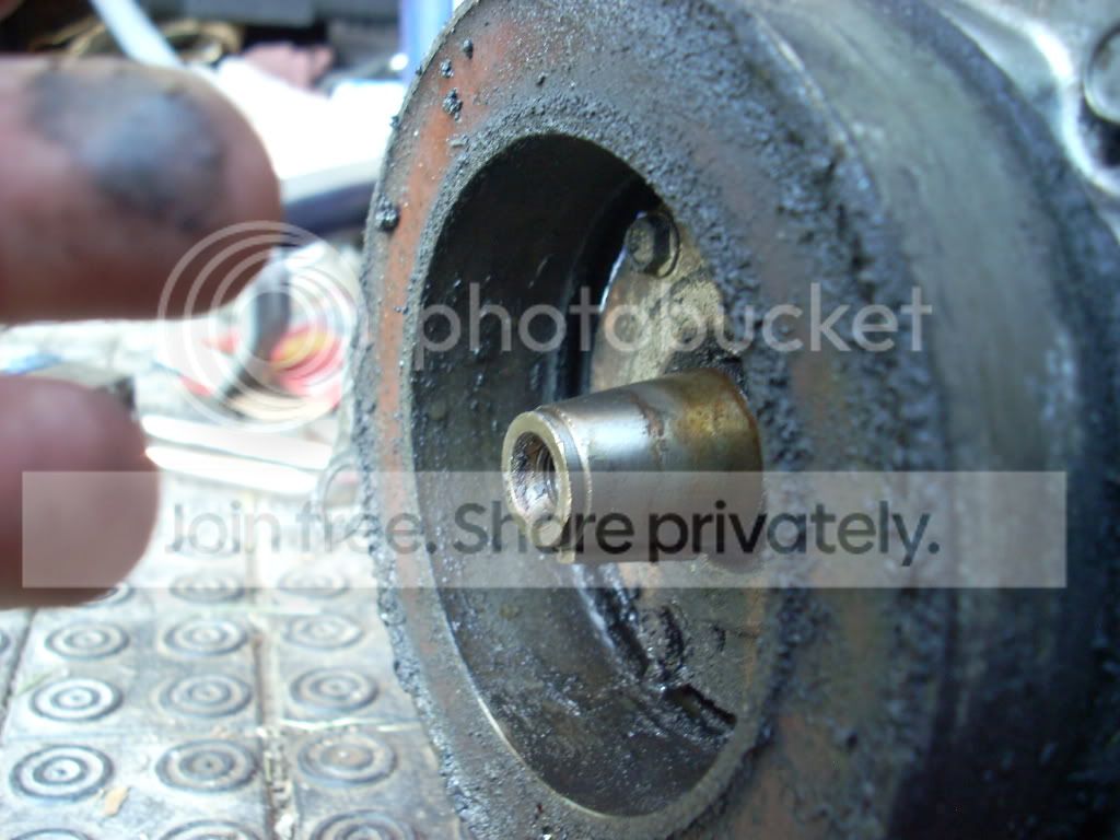

That's the shaft. According to the tag on the compressor, it's a sub compact 209 compressor, but the shaft is a bit different than the diagrams online.
Anybody have any guess at what this one is?
Yeah, I've seen that chart. Thanks though.
The thing that makes me wonder is that I don't really have a groove so much as a step.
I wonder if the groove just got worn down.
No, the plate is there. Says SC209R and some odd else on the model number location.
I'm just not entirely sure that nameplate is original to the compressor.
I'm hoping to run impact guns on this occasionally and surely don't want a short stroke.
I assume the medium stroke will run an impact gun, but I'm unsure.
