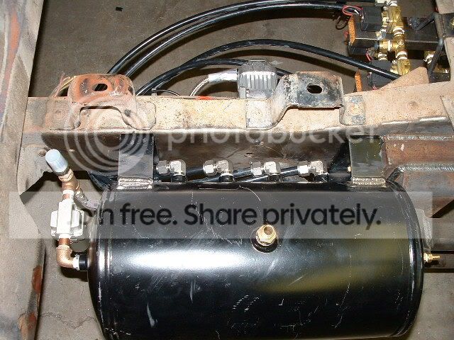

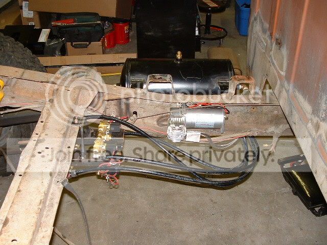

I think I am going to abandon my idea. I am going to try to come up with a suitable location in the bed and follow your lead. Thanks for the pic's.
Do you still use the bed of your truck for hauling stuff?
Just an idea to expand on your tank mount frame. Extend the bottom horizontal rails and the feet to just on the other side of the wheel wells. One reason is that if you ever haul in plywood or such, you'll still be able to close the tailgate(if you still have it) and two, you can make mounts for other stuff out of the extra frame of the tank mount on each side of your tank next to the bed sides.
I thought about doing that, but I have a mount for my 20Lb CO2 bottle on the front side of the pass wheel-well.
I will do some measuring today to see if I can arrange it all.
