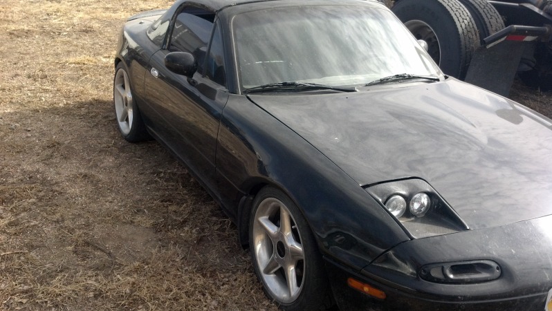

I then bought a '94 Miata for the drivetrain.

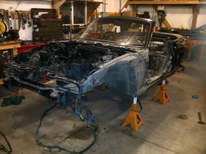

In two days it looked like this.

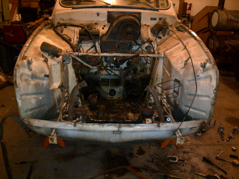

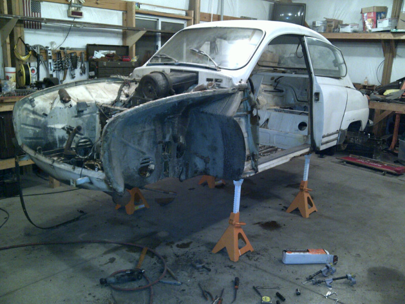

Drug the Miata hulk out and drug in the SAAB

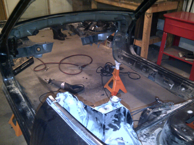

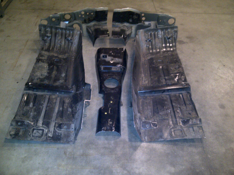

Cut out the floor and firewall
