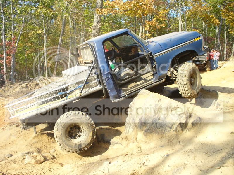

If you'd like the protection but don't do stuff like this:
you can probably get by with .120" wall.

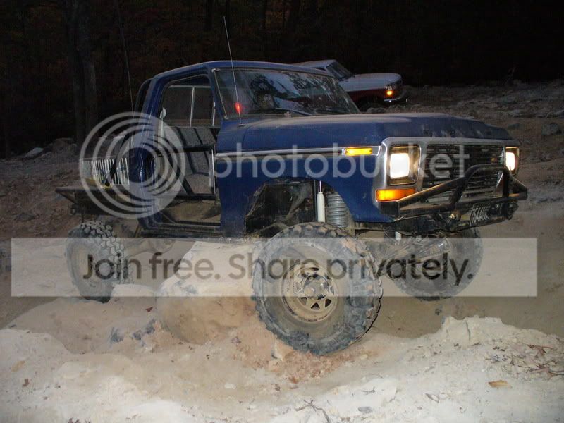

I know I want to do stuff like this so Im boat siding my k5.
The best pic I have. 3x3 square tube, .188" thick. I've hit them pretty hard several times and the only damage is scratched paint. I use them all the time to pivot the entire truck around trees and rocks. They are not tied to the frame at all but welded all along the A and B pillars, the floors are 1/8" plate, and there is 2" angle and 1.5" square tube supports (2 of each) running from the body "subframe" out to the sliders.
