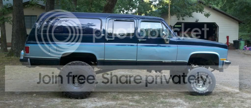

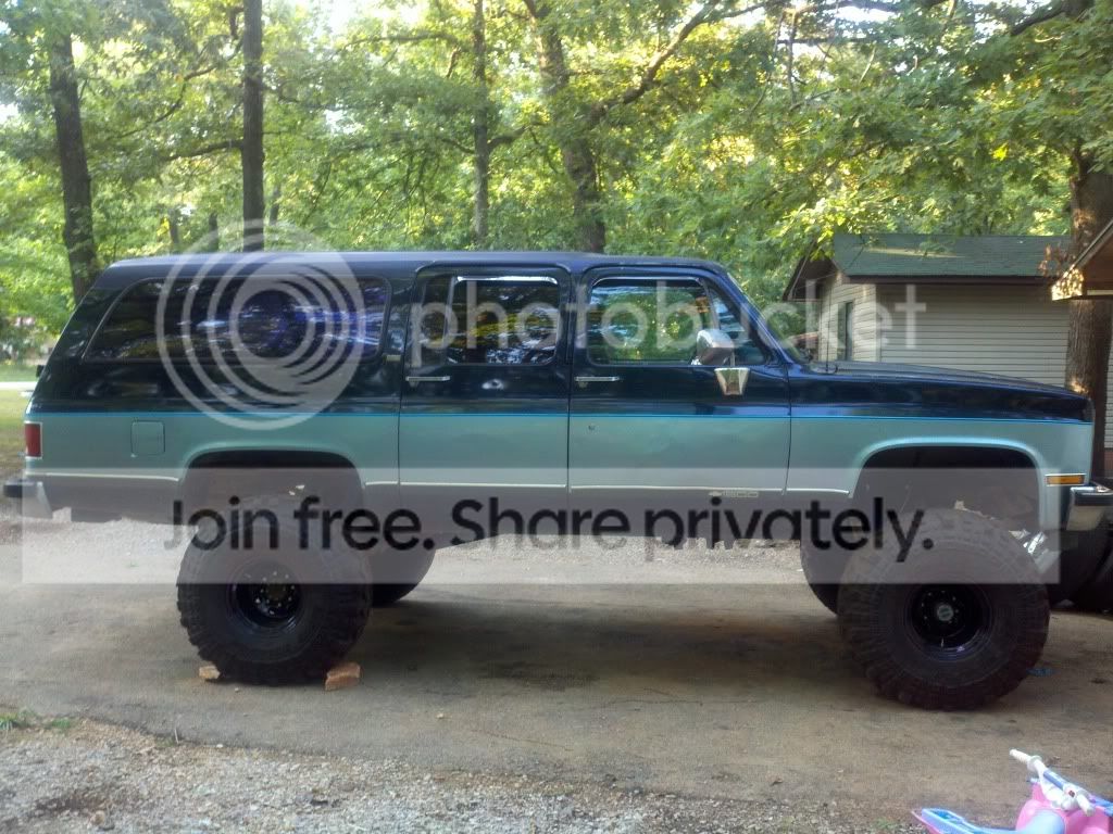

Update
Ok, here is where we are today. Dana 60 front installed, 14 bolt rear installed, 8" BDS spring lift front and rear, 38" TSL/SX's, 15x12 Barts with 3.5" bs.
TA-DAAAA!!!
money shot:thumb::thumb:
did you grind down your calipers for the 15" rims?
I didn't do them, but yes they have be ground down. The PO of the axles had already taken care of that and a disc conversion on the 14 bolt.
Also, the ORD crossover steering is installed and working really well:thumb::thumb:. I'm super satisfied with their kit and overall quality and fit.
Got the Sub in the shop today to get the king pins replaced and then front end aligned.
