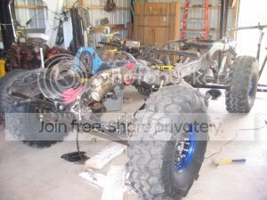

Thanks for the pics and info Rootbreaker. I understand what you're saying about test it out, just tough right now, look at my blazer.....not ready for that right now.
that looks good man, what motor/tranny/t-case is that baby gona have? are those recentered H1's? looks sweet
pic blocked at work so gotta wait till I get home... :doah:
I'm putting in a built 496 with a th400 transmission and a 205 transfer case. The h1's have the 7" backspacing. My dana 60 front is from a dually and i have 4" spacers in the rear. Also got my 35 spline outers with all chromoly axles and front and rear detroits. Can't wait to get it going.
