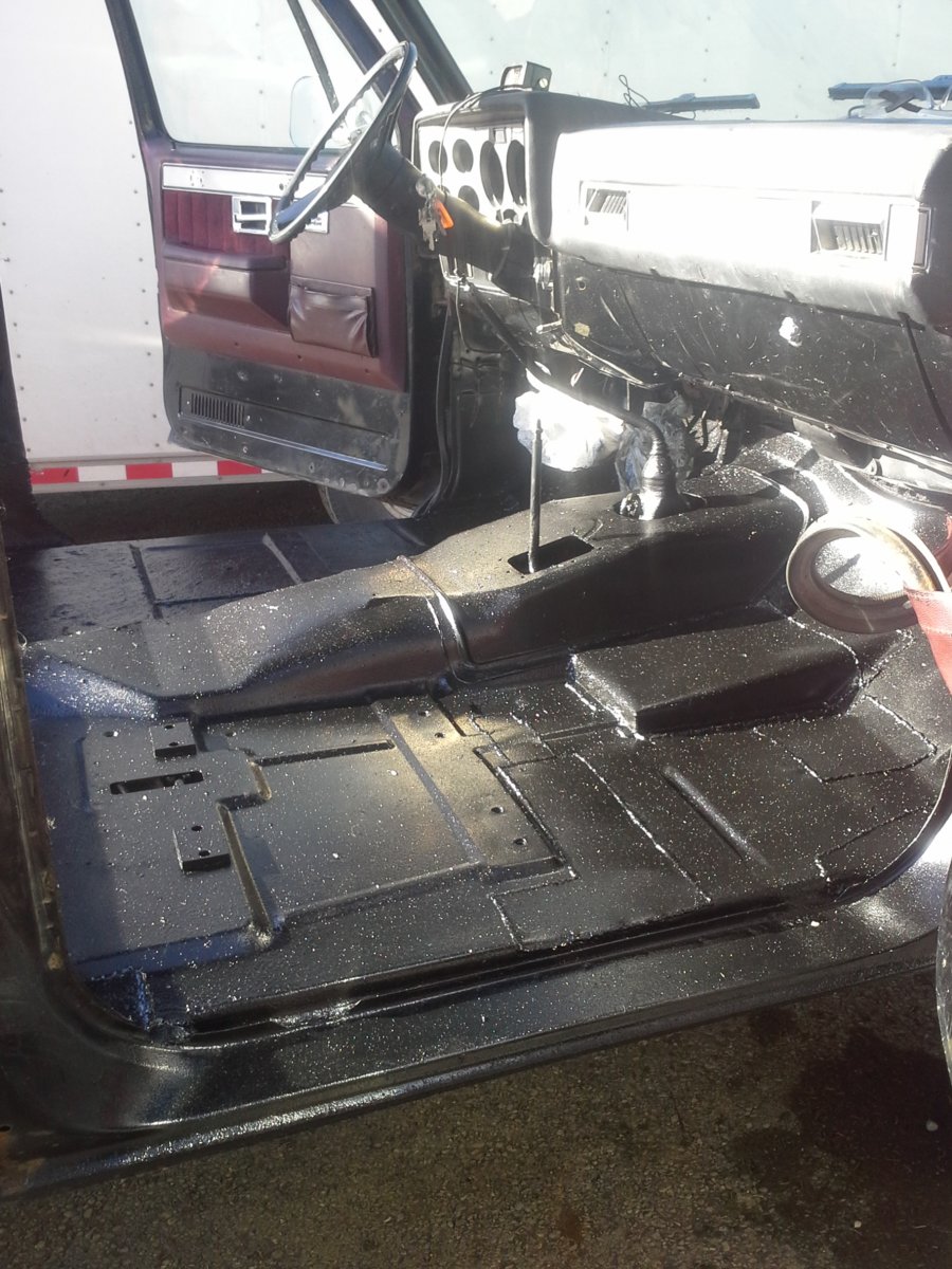

sprayed up front.  I thought I might reinstall the carpet so I did not grind the welds... But decided to just leave it sprayed out in Rino Guard
MorganBrady
Notice I cut drain notches through the weather strip rail on the bottom. I made sure to cut the weather strip back too. No longer is a mud and water trap, won't rust out there now.
85 Diesel Jimmy floor rust stainless repair and roll cage rework
