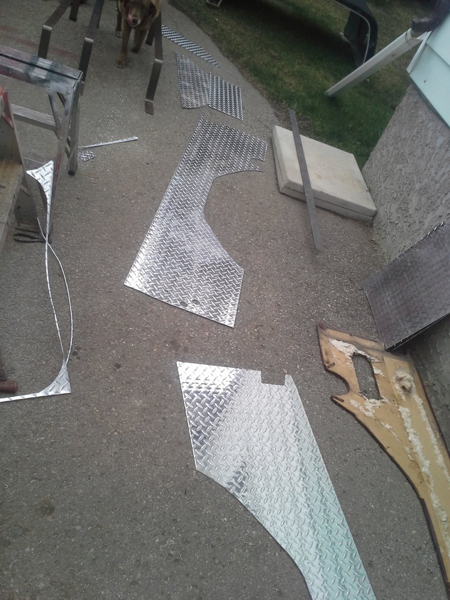

The aluminum cuts easily with a jig saw if you keep the blade wet with soapy water to prevent aluminum from sticking to the saw
