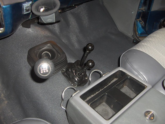

When I do the NV4500 swap I am looking at using a Dodge 241 or GMT400 floor shifter assembly to avoid interference with the GMT400/800 shifter boot assembly I will be using. That said, the linkage will be changing anyway.
This is a picture of the NV4500/205 in my K10. I used a ’92-’94 shift lever, GMT400/800 shifter boot and bezel as well as an ORD twin stick. This is the same exact shifter lever and boot assembly I picked up for the NV4500 swap into the Burb. Anybody have any recommendations on a shifter assembly concoction that works with this set up when using a 241? I don’t think the Burbs stock shifter assembly and bezel will fit this boot assembly. In doing some research it looks like a ’93 and later Dodge shifter assembly would be the easiest and cleanest to install. A GMT400/800 might work as well.
