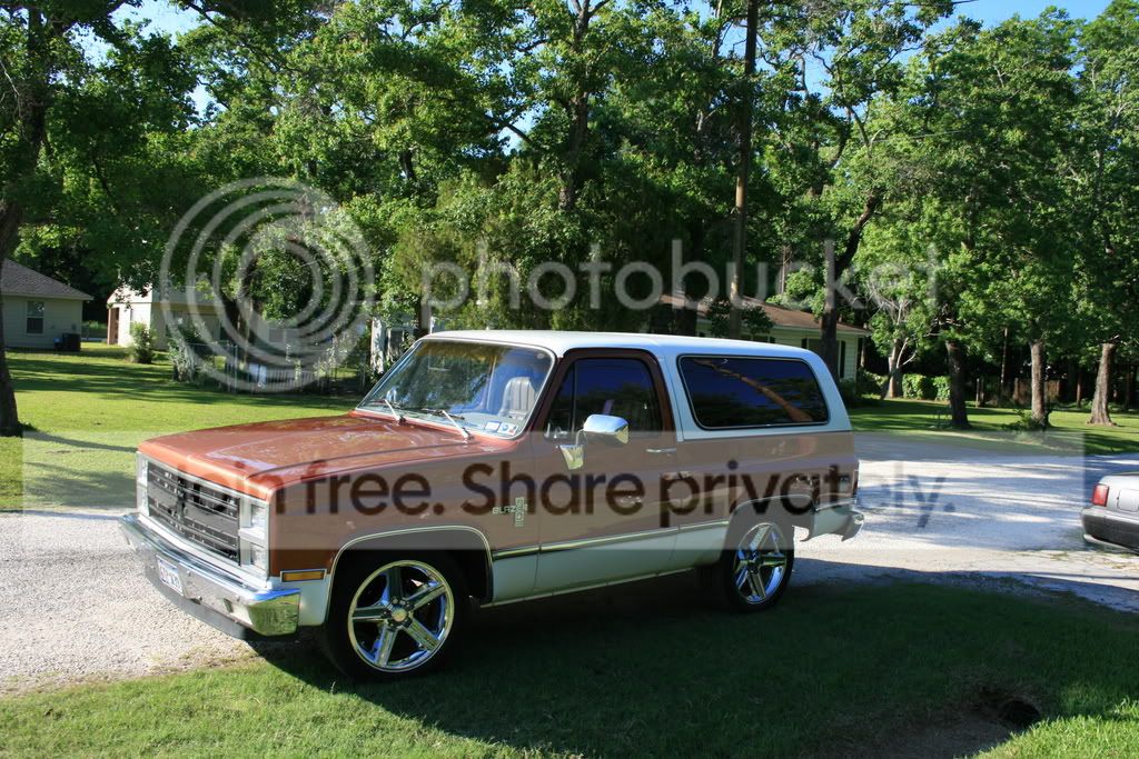

this blazer here has 20x9 wheels with 5.5 backspacing and I dont think it looks all that bad. Would I have problems hitting the the tie rod? (and no I dont want to ghetto it out.) I just need some cheap tires to move it around. I found someone who only wants 200 for the wheels and tires.
With an 18" rim you should clear tie rod stuff easily. The tires and rims will be somewhat tucked in with that backspace though. Probably an inch to an inch and a half further tucked in than stock GM rims...

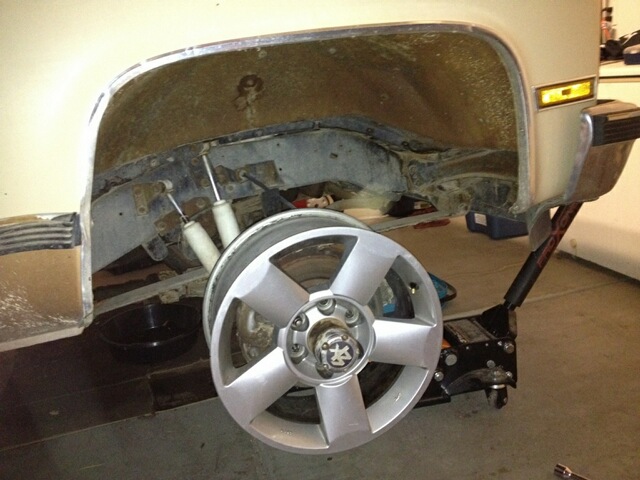

well i got the wheels yesterday and tried them on. The lug pattern is the same, but the center hole is too small. I took them to a machine shop and had the hole bored out. I got the wheels from him today, but the tire shop in town had already closed. So here is a pic with the wheel on the axle. I'll have the wheel and tires mounted and ready for pics tomorrow. I really like these titan wheels.

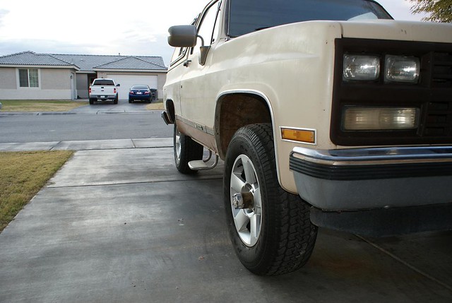

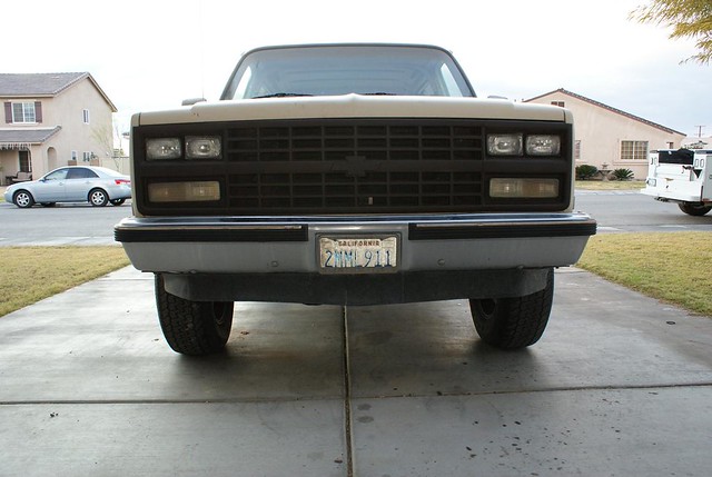

Got a pic from the front? Interested to see how much further in they are compared to stock.
well I had to bore the center hole to chevy specs, 3" to 3.5" i believe, so im sure now I can find a chevy center cap since its the same size center. The nissan caps wont fit any more. AJMBLAZER I'll take a pic of the front for you when I get home from work.

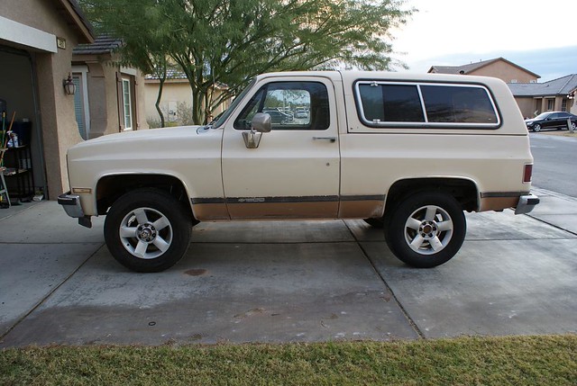

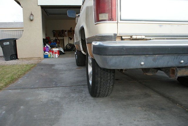

Here are some better pics of them in the sunlight. I'm definitely going to need some spacers in the rear. I'm thinking 2" spacers.
I figure most newer trucks are coming out with 18" wheels so it should be easier to find used tires.
That one is a 2wd. That being said, the titan rims look pretty good on the K5

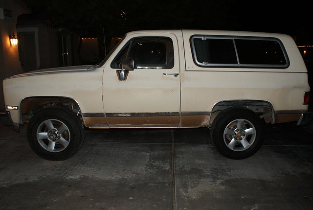

I did the metric conversion on the tires that are on it now and they are just under 33's. I think it was 32.4 in., those wheels make the tire look small. With 18's im thinking at least a 35, but this is just temporary so that i can drive it around.
