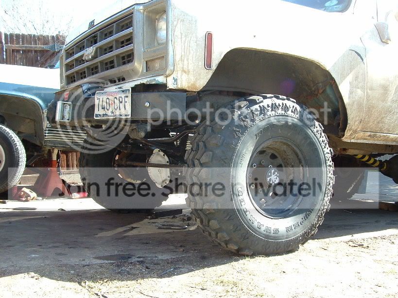

1 ton at last!
MattK
Jan 12, 2005
1,713
2
Dallas, TX
Rock on!!!

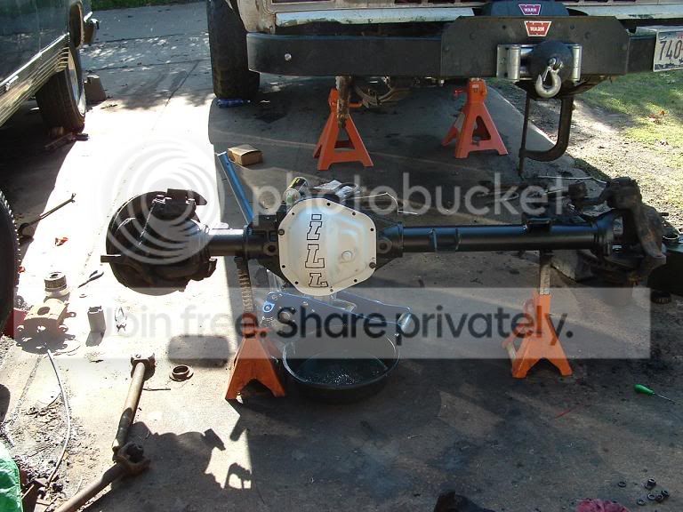

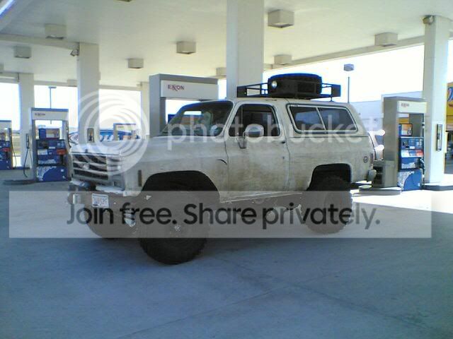

sold the 10b
installed! detroit, 35 spline and polyperformance flanges.
finally drove it today. felt good, didn't even notice the detroit up front. poser pics i know, but i'll get some good ones up soon.
you said you didn't notice the detroit with flanges? Is that true. I was pondering that route.
You WILL notice a Detriot with flanges. My truggy had the same set-up as matts rig. It would crawl like a tractor, but the turning radius in 4wd was huge compared to what it was in 2wd. It's also ALOT harder to turn, i got into the habit of tossing it into 2wd if I ddn't need 4wd, just to ease the effort. (this was pre hydro assist...42" tsl's)
That said, I still wouldn't trade a Detriot for anything else in a truggy/buggy. For an on the road rig.....ARB for sure.
i love my detroit in my 60, assist makes it so sweet :).
i like the white diff cover, we'll see how long it stays nice and white haha
Yessss! Looks good man. Didn't you get some 35 spline lockouts also? I think you'd be better off running those while seeing lots of street duty. I haven't run my flanges in at least a year... so much easier on everything. Lemme know when we can go do some real world testing!
