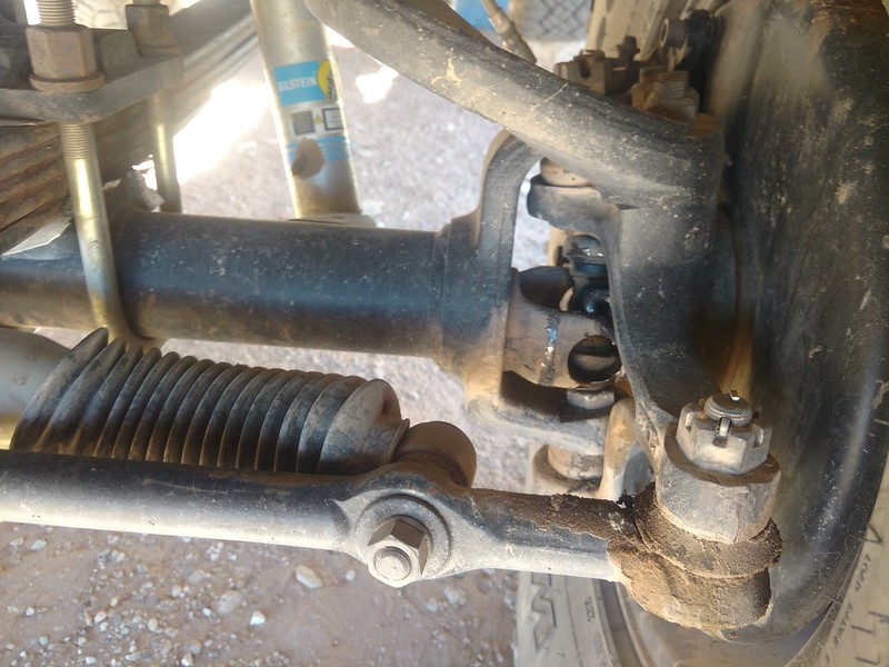

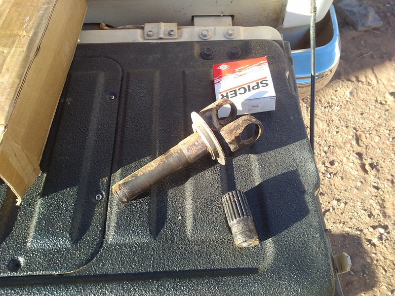

First failure on my D44. Keep this in mind, the outers are the same between the D44 and 10b. This was the pass side outer.

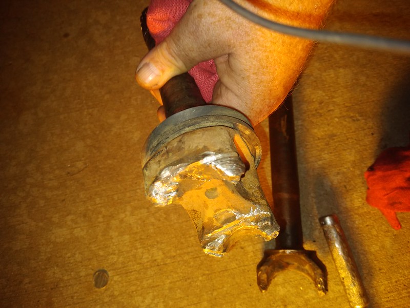

Driver side. Took out the inner and outer.
Blazer Bash carnage (pass side outer and inner):
I can pretty much confirm every time I've had a break I was backing up. First pic I got stuck in sand and had to back out. Second pic was also in sand and had to back out. Third was on slickrock/dirt and I got hung up moving forward and had to back up to reposition.
I'm running a Tru-trac helical limited slip that is pretty tight which did contribute to my shaft's demise.

After the second time, it sure made me leery of it. But each time I had buried the front end and had to go back to get out. I was never deep enough to require help to get extracted in either situation.
I honestly feel that the tight Tru-trac and shift to reverse with the 700r4 allowed a quick release of torque when the change in direction happened. On last year's desert trip we retraced our steps on the trail I broke the passenger side shaft on in '17. A large chunk of the Eva Conover trail is a dry riverbed. I didn't get stuck, but the plan was to put the t-case in neutral prior to shifting to reverse. The idea was to disconnect the driveline from the auto trans as the torque converter could be holding a slight amount of torque on the system. It was our theory at least.
