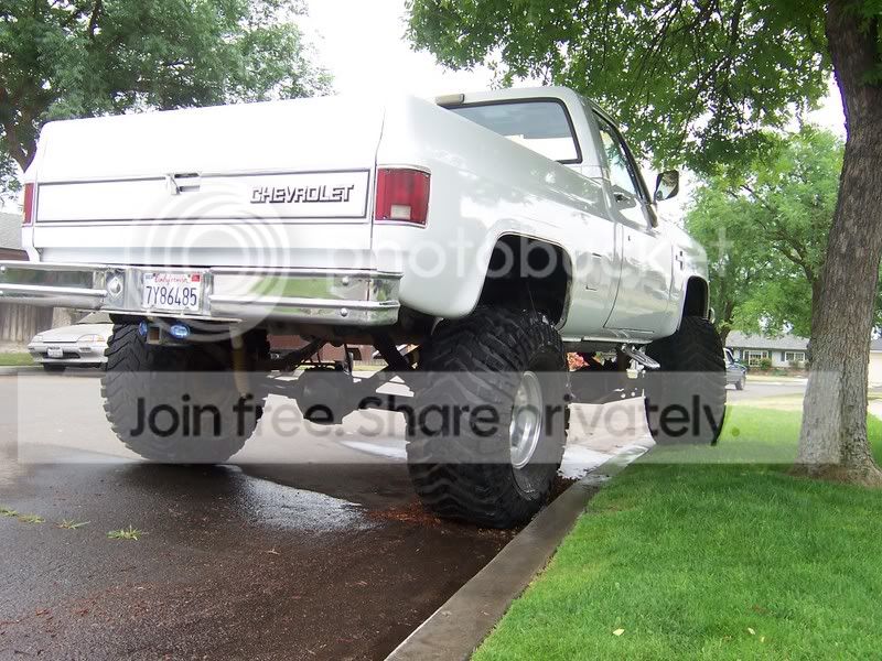

I still can't believe it didn't snap.... probably b/c of the stupid high gearing but none-the-less it survived....
38.5/16-15's
