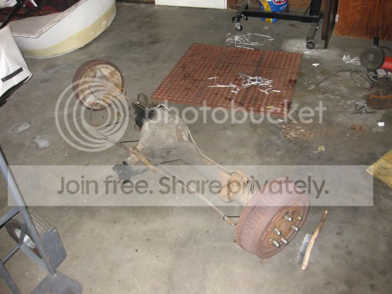

Has 140k on it pulled from a 88 burb I converted to 8 lug. 50 bux. here it is, even has the lugs
