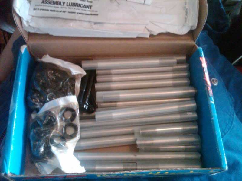

:D I've got a ringed 12v head and 625ARPs in my garage ready to go :bow:
