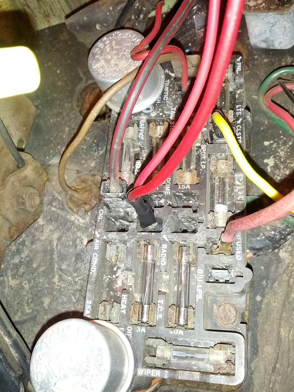

See the lower right red wire, that's Ignition Unfused. The yellow wire is the cluster feed:
You can tap into the fuse box where it says "PNL " near that yellow wire,to feed the gauge light,so it only comes on with the light switch...there might be an empty tab for a male connector in the box at that location..
You'll have to use a test light to find which tap on the fuse box supplies 12V with the key "on" only--be sure its not hot with the key on "acc" too..if there is no unused taps,you may have to splice into an existing wire or use a double spade connector to allow two wires to feed off one tap..
