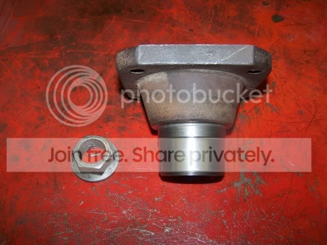

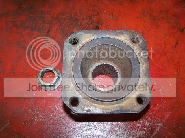

im actually running a 1410 non cv square front driveshaft and a rockwell rear shaft...i bought a 1410 flange from 1 ton mudder that is basically a 32 spline 205 yoke with a flange machined onto it..pic for refrence
