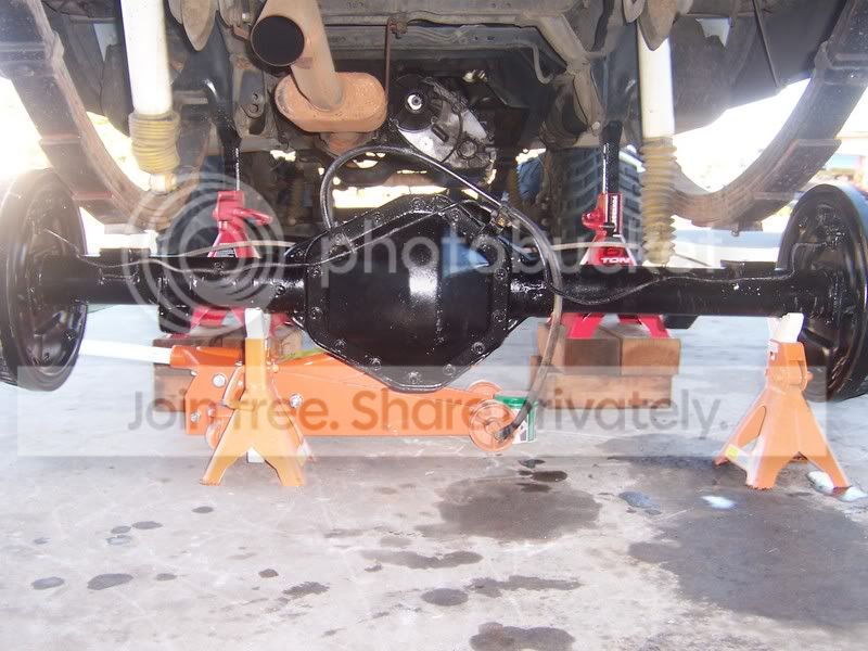

14SF axles look like this...
^^^ That's an 8 lug 14SF but there are 6 lug versions as well...
