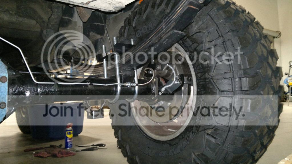

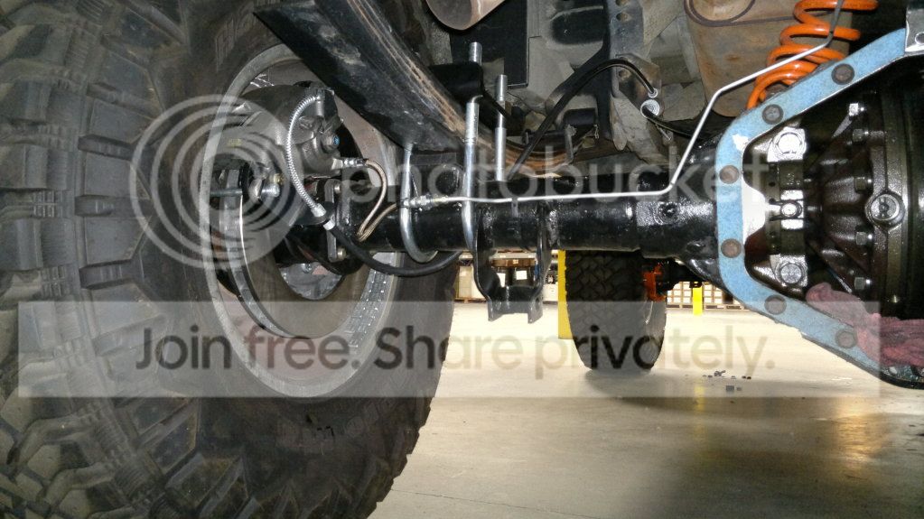

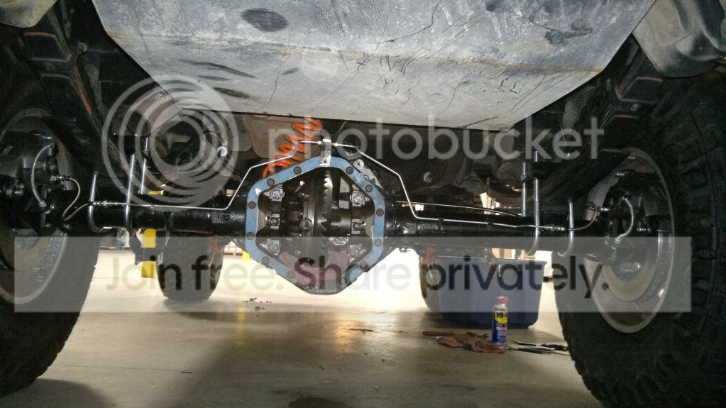

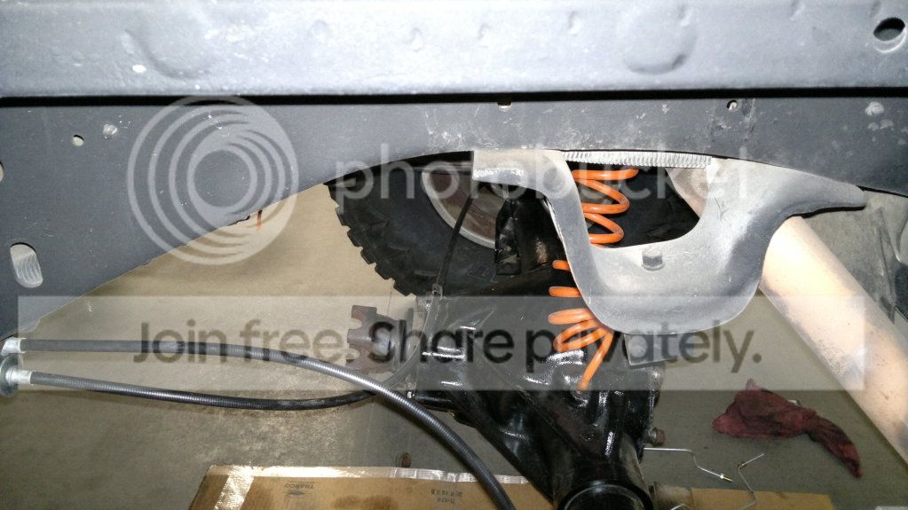

I see in your post that you figured out the E-brake cables for your 14 BFF disc brake swap.
Who did you get the E-brake cables from and what all did you order. I am having a heck of a time figuring out what to order right the first time.
Please share.
Thank you.
Sean
INFO is for skidog
i used the stock K5 parking brake cables and made some new hard lines for the brakes
