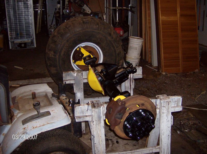

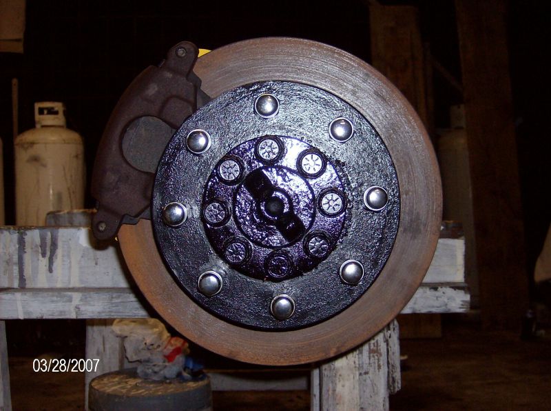

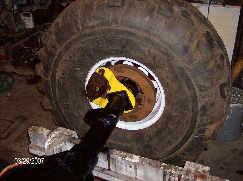

New bearings, seals, cleaned & painted most things. Disc brake conversion. I need to paint the calipers pretty, but I'm waiting until I've fitted the 15" wheels to the front 16, then I'll paint all 4 calipers at the same time.
Only thing left on the is to mount the brake t fitting and run the lines. I'll be using soft lines (recycled from the front of the truck on the last build). Just have to find a t fitting with 2 male 3/16" IF fittings and either a male -4 or a female 1/4" IF. I'm thinking a couple adapters might be needed to make it work.

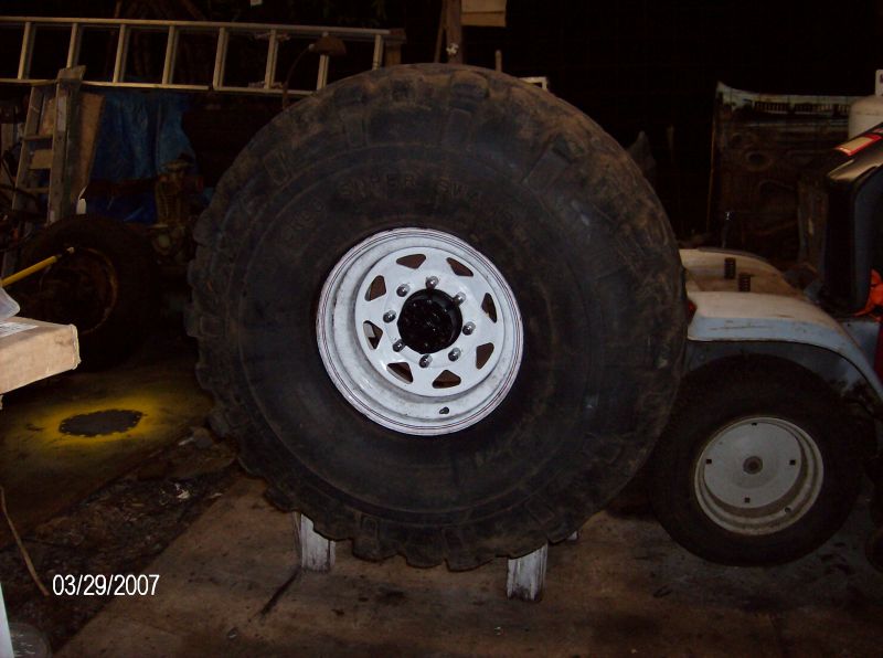

For giggles when test fitting my 15" wheels for clearance, I used the one with my spare 42" TSL.

I didn't think you could use 15" wheels on a 14bff? I thought you had to have 8 lug rims.
Or do they make 8 lug/15" rims? Sorry I just thought if you wanted to run 14bff you had to get 8 lug wheels?
Please explain to the nOOb? Thanks
Larry
Yes they make 15"/8-lug wheels.
