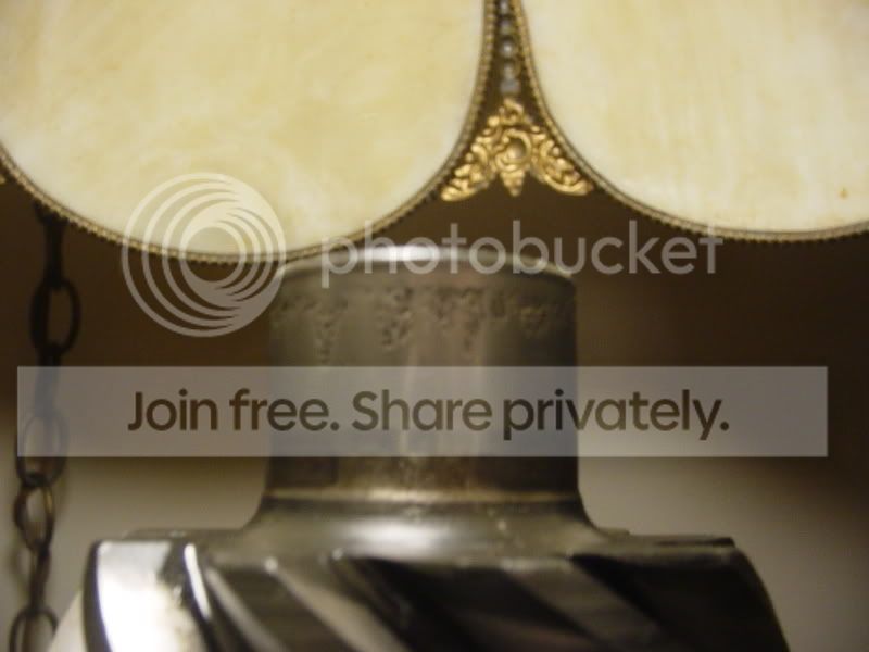

Hey guys.. i recently got a 14bolt.. the pinion bearing was bad though so i took it apart.. bought some new bearings from napa and a GM crush sleavee i sat w/ my laptop next to the press and was on pirate4x4.com reading the 14bolt gear install.. following it step by step.. using a 60ton press.. and a 1000 ft/lb impact wrench... I cannot for the life of me get the crush sleave to crush.. It seems as if the top bearing right under the seal wont go down the last tiny bit w/ the pinion nut tight as hell. The only thing i can think of is the bearing is the wrong size.. yet again i dotn know if that can be right because the bearing does press on the pinion a ton.. just not enough to crush the sleave... any ideas? Or.. whats the average price a shop would charge to do this? Also.. how bad is this to use.. i dont have another option cuz im poor after buying this... so just curious what will happen.

If the surface on that pinion is pitted like it looks it is shot....then again I could be wrong since I cant see it in person. My guess is it is not lettin the pin sit all the way down in pinion support. some crush sleeves are a pita to get to crush.

Do not heat it. Also the end of that pinion won't hurt a thing. That is only the pinion pilot bearing surface, most diffs don't even have that.
Not all diffs have the same pinion bearing seperation either. That third pinion bearing undoubtedly undergoes some force under heavy load.
