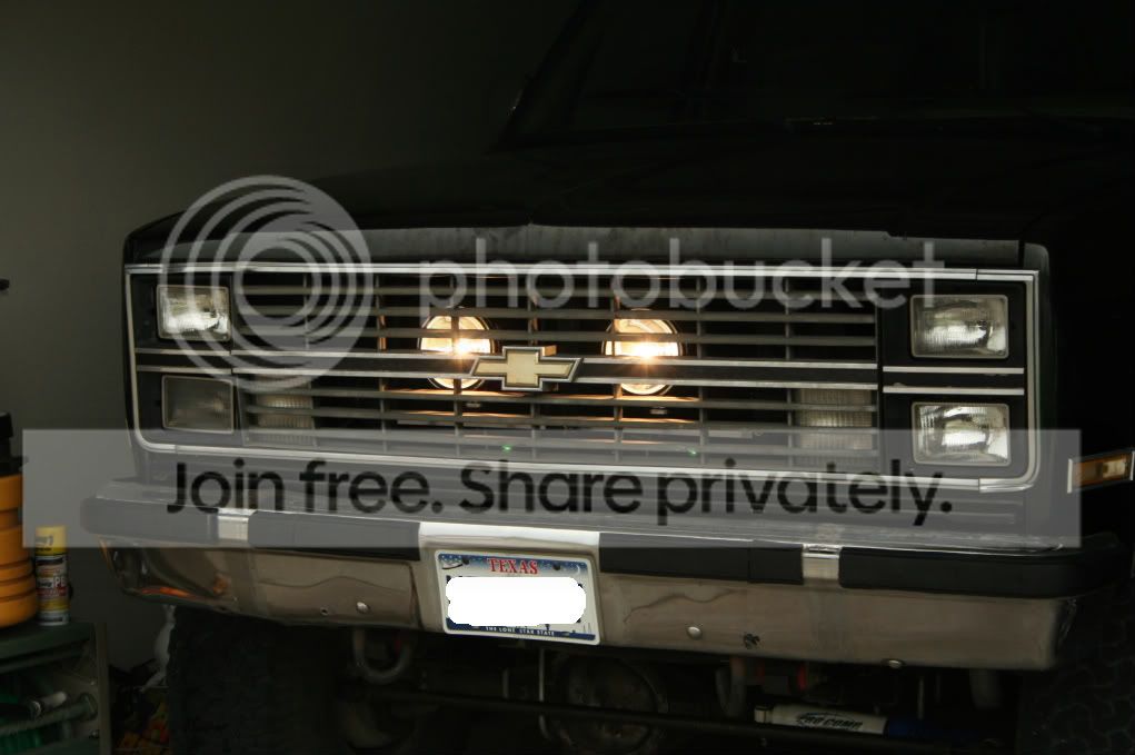

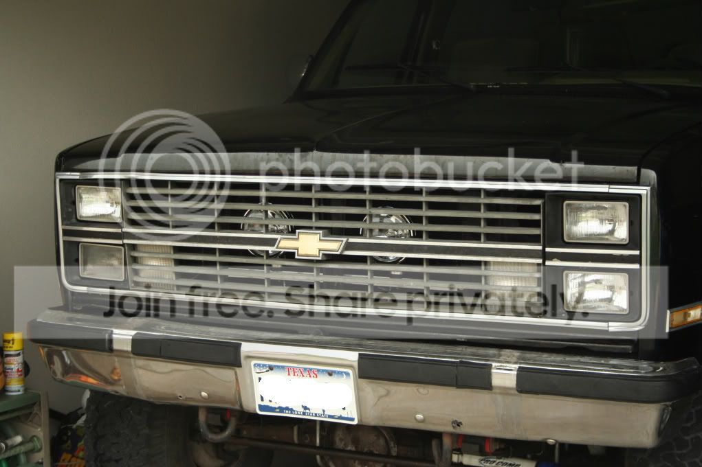

:waytogo:I love Chevy305s mount up.
I wish I could mount mine like that. I have a tubular grill and a grill guard with the tubes that come across the middle so I think I'm outta luck unless I take some of that stuff off or run a light bar. But if I run a light bar, the Blazer won't fit in the garage...
Anyways +1 for Chevy305
Thanks :D
Yea, I'm with you on this one. It kinda defeats the purpose of the light in the first place
Yeah the grill will cut down the beam some but believe me mine do just fine.

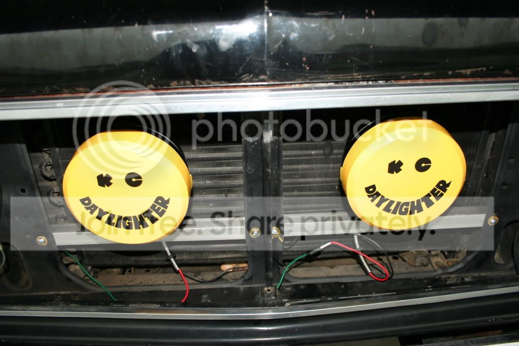

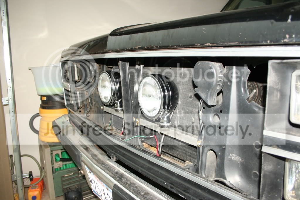

I decided to do this with my k5. Got hold of some 6" 100w Kc Daylighters Thanks for the info with this.
Did you use 1" angle iron for your bracket?
I had some 55watt behind the grill. I mounted them in the location for the air horns on the rad. support. Just punched out the tabs and put an L bracket and mounted them up. The 55watt lights got warm, not sure how 155watt lights would be, You could spray the back of the grill with some hi temp paint if your that worried about it. I didnt lose too much light output behind the grill, but its not optimum for sure.
Chevy305,
You're welcome... I believe it was 1". I just picked it up at homedepot and still have some left over.
