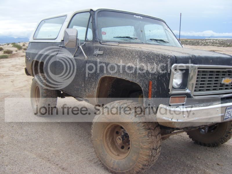

what sucks is that the other 2 trucks that made it had mud tires and my tires are all-terrain and they just turned into slicks with the clay
What I saw was the other trucks had better gearing and or more power to get the tires to self clean. You had so little real wheel spin it's no wonder they caked up.
I'm gonna guess you got 3.73's at best, but it really looks like you have 3.08's by the way your truck is performing.
Watch one of your vids, except just listen to the truck. Now watch the other black K5 and really listen to the difference.
