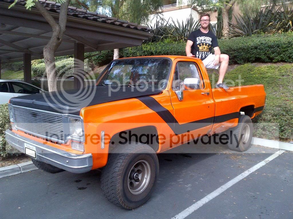

Found my K10 on CL about a month ago. Been dealing with the little "fix-it" issues as they arise, looking forward to building it up into a badass expedition & adventure rig as time goes on.

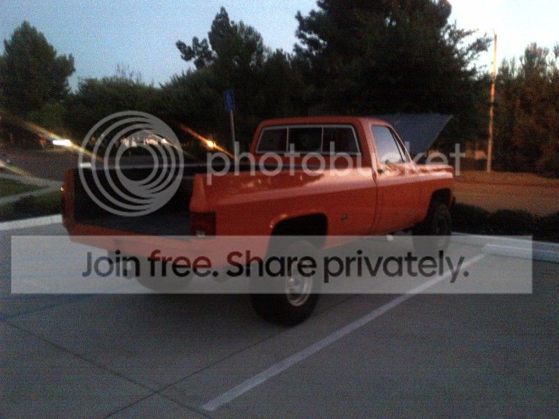

They day I brought her home:

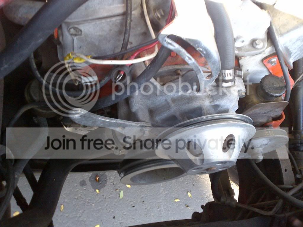

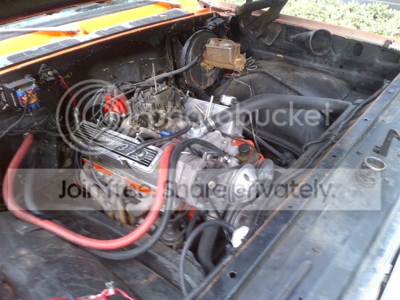

Has a nice Alu-headed 350:

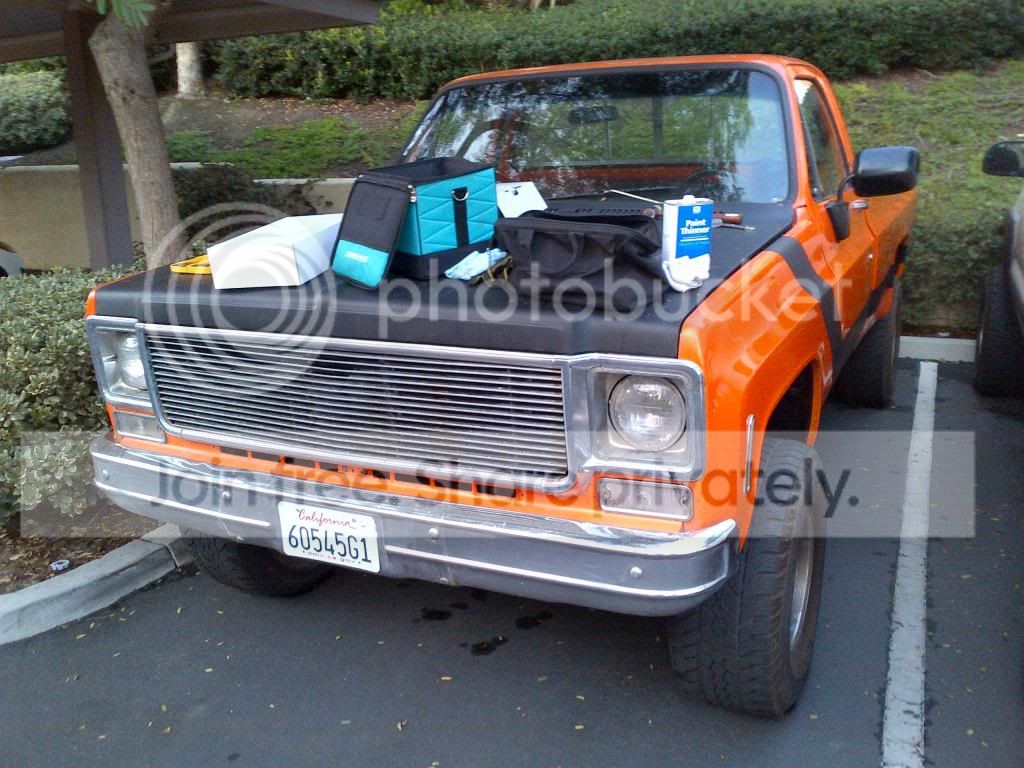

Couldn't be orange without a flat black hood and racing stripe:

Annoying hood gap at the rear with the hood riding high above the cowl. Any thoughts on how to fix this?

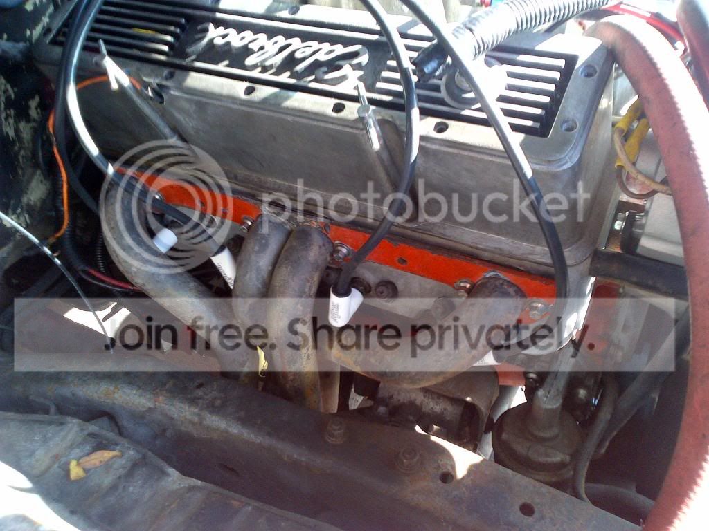

The truck is burning up starters like crazy. About to go through my second one since I've owned it. Underhood temps are high and with the headers basically touching the starter I think I'm frying the solenoid. Starter wrap makes no difference, getting ready to wrap the headers when I replace this starter in the near future. Any ideas?

Thats a sweet truck man, has a great stance.
For your started problem, what if you tried gettting an aftermarket underdrive starter, they make them smaller than the huge stock one i believe.
You can also buy a factory Gm gear reduction starter for the newer year 350s. Its alot smaller, and it has that cool sound when it cranks over. A bit pricy though.
FYI header wrap will rot the headers out.

Looking to avoid the header wrap if possible - for the price I could get close to the price of a new starter anyways.
What year truck / 350's should I be looking at? Something like a 1997 C1500?
Im not sure on the 350s. I know my 454 is a 2000 model year, and it came factory with one. But since I bought the motor at an auction, it didnt have a starter. So i tossed an older style one on it to save money.
That being said, what I would do is have your parts house grab out a generic 80s model starter, as SB and BB are all the same. Then have them grab a newer one, I think 97 would be gear reduction, and look at them. The gear reduction should be much smaller, and alot lighter. Make sure the bolt pattern to mount it is the same. Once you get the right one, your good to go.
W.r.t. the starter, yep, the solenoid is the first to go. I used to replace starters biannually, but since I started using the Dorman heatshield, I haven't replaced any. That includes my built 468 BBC with unwrapped headers.
http://www.dormanproducts.com/p-3269-45629.aspx
Cheap, simple.
Mind you, I also got good starters -- IIRC, the current ones are Delcos, from a dealer. They're not gear reduction or anything goofy, just stock style. My motor guy says you maybe want those for a crazy high compression race engine, but for regular motors, get a regular starter.
