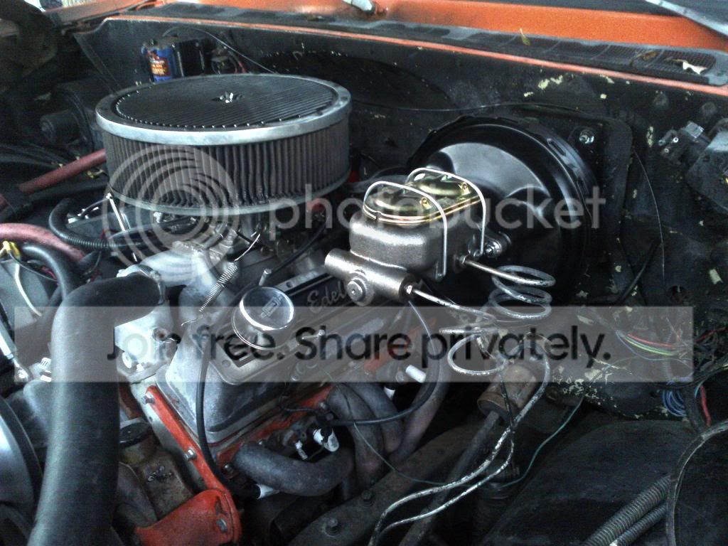

Took the advice you guys have and swapped in a new MC / vacuum boost over the weekend.
While I was at it, gave a full system flush and bleed with my buddy's help.
Braking has improved a decent amount, but I still don't feel like it's where I want it to be. Ordered ORD's SS flex lines today, hope I can get them by the weekend and do another round on the brakes.
My truck has a D44 front. Any caliper / rotor combos that I can bolt on for increased stopping power?

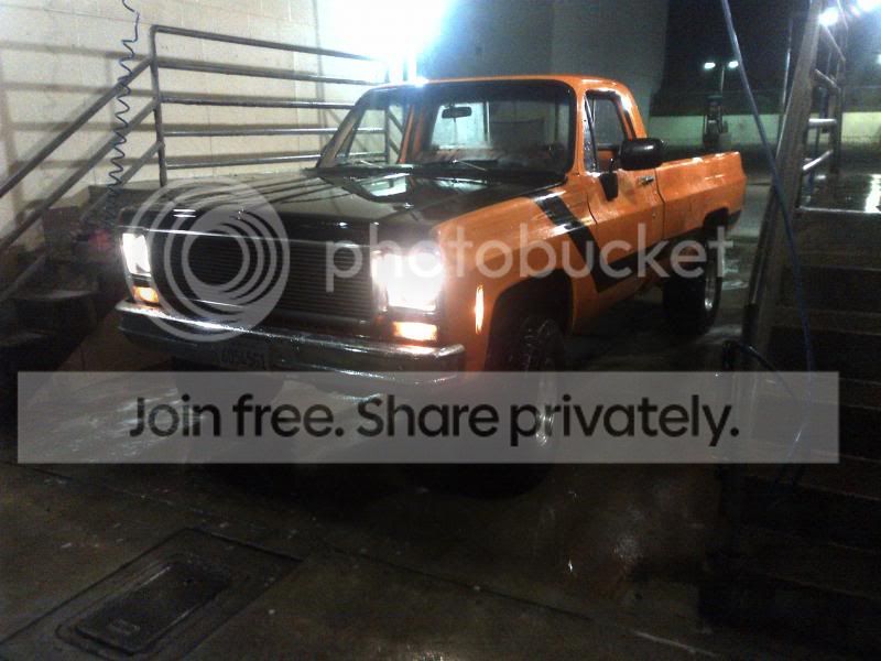

Gave hit the wheels and windshield with 0000 steel wool during cleanup. They SHINE now.

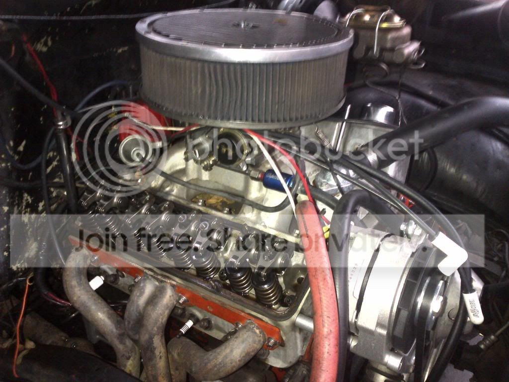

Cleaning up vaccuum lines to where I can flip the passenger side valve cover with PCV the right way around. Much to my surprise:
PO installed roller rockers! Pleasant surprise.

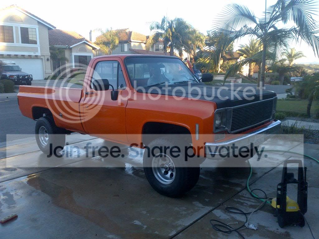

Tinkered with the carb, took it on the highway, took it for a wash. Got the 37's, still waiting on the 16.5's to mount them up!
Finally picked the tires off the production floor at work - 37" of MT/R goodness x5.
Mocked up, waiting on my 16.5's to come through so I can mount them and lift / trim accordingly!!!
Super pumped.
