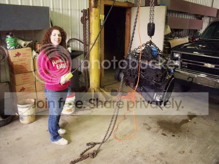

I had faith in my woman :waytogo: all i had to say was up/down and she pressed the button and i got a pry bar :D:woot:
