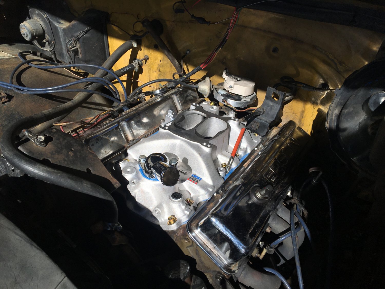

I went deep into my archives last night and found some old dusty history books pertaining to carb tuning in effort to figure out which meter setup I should run for my application. Through my research I found a reference to manifold design, specifically square bore VS spread bore and the symptoms one would have if they ran a 1406 style carb (square bore) on a spread-bore manifold. Apparently there are some ports that would be open therefore causing a vacuum leak which would then cause a rich condition at idle :thinking: I didn't have time to pull the numbers off my manifold however I was able to locate some old photos on my PC from the manifold swap right before I installed the Q-Jet. Looky there.....:doah:
