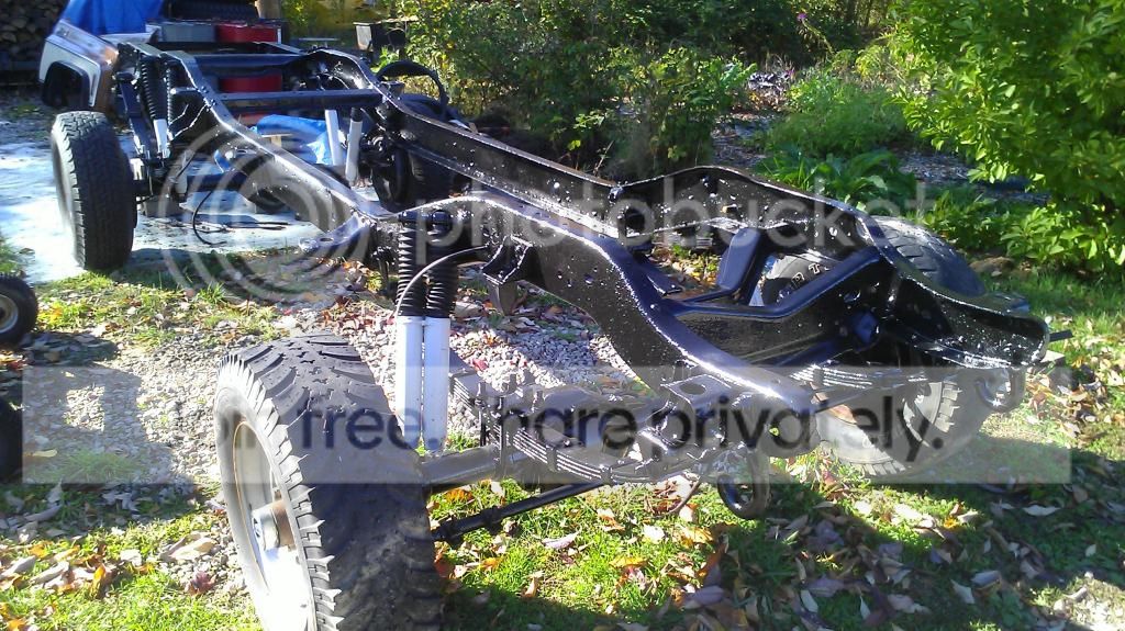

Sorry it's been a while since I updated the build. Here's some progress pics:
The frame, coated with POR15.

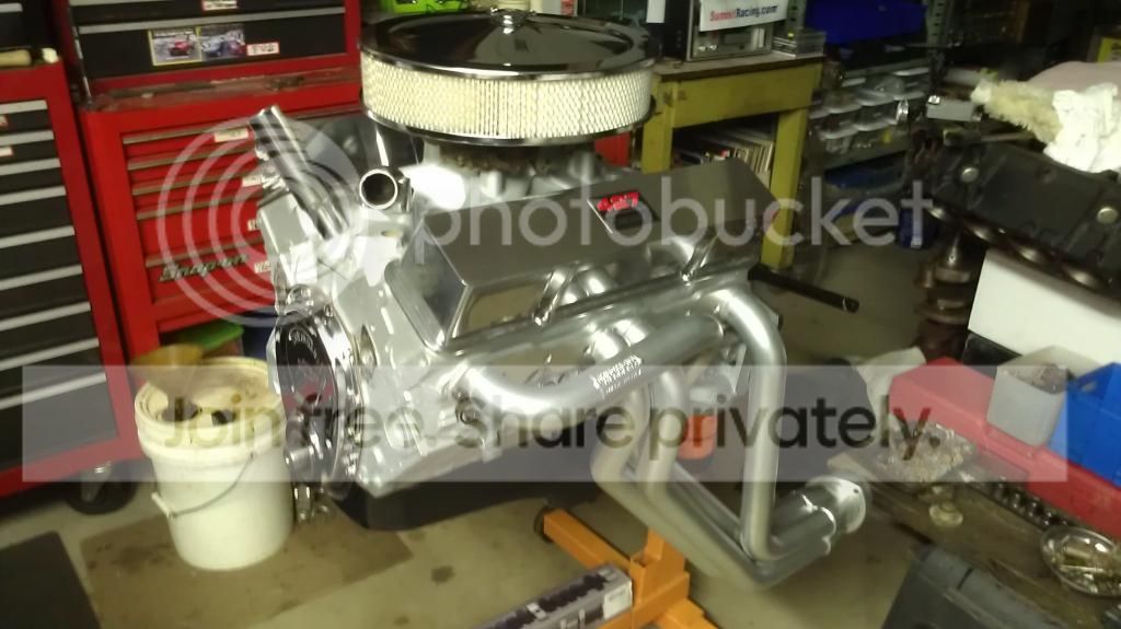

The 427 is close to completion. I also have a matching silver rebuilt TH400.
