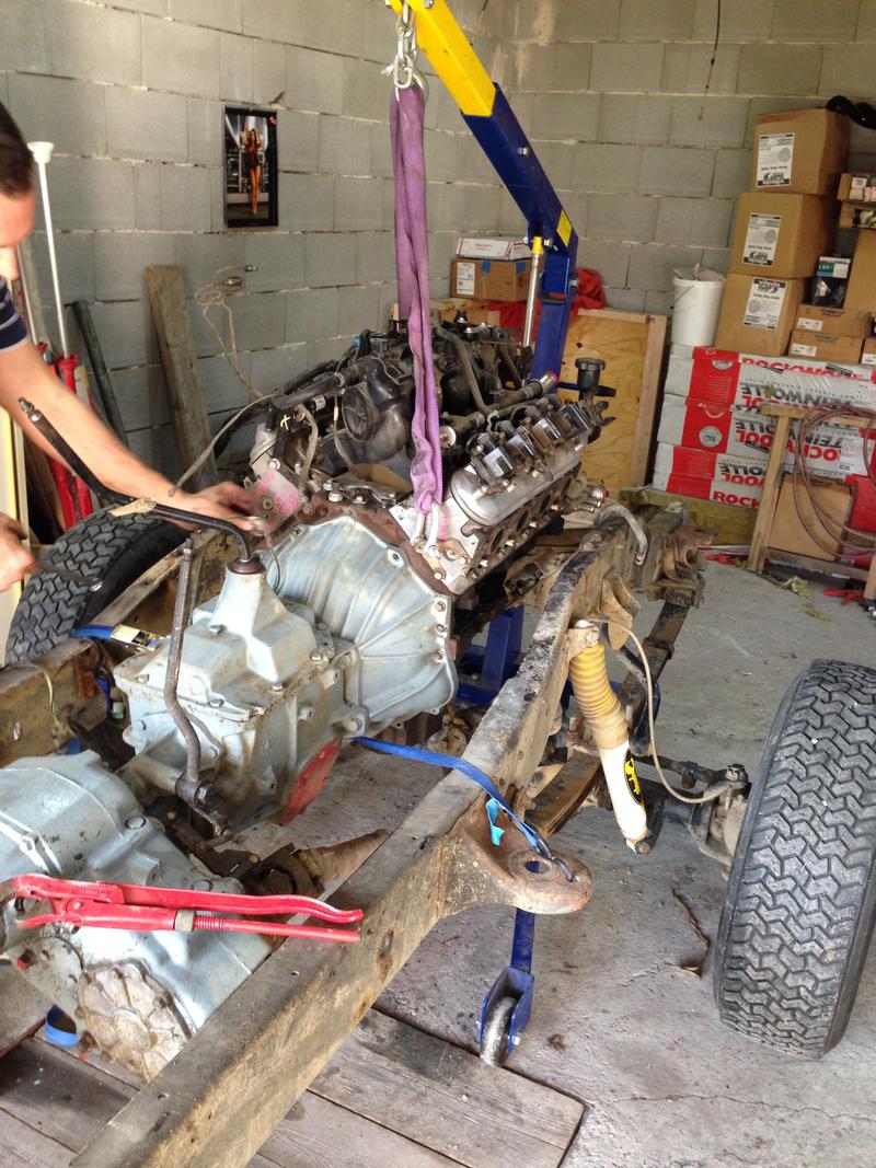

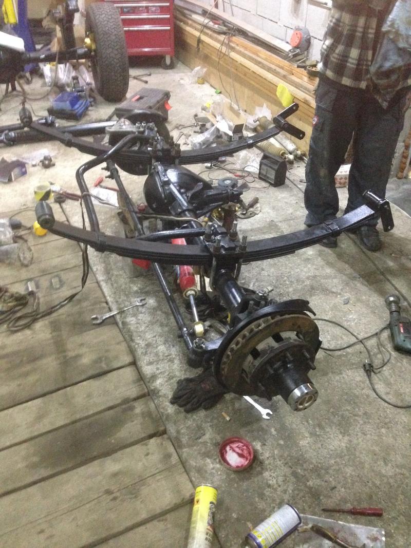

Planned

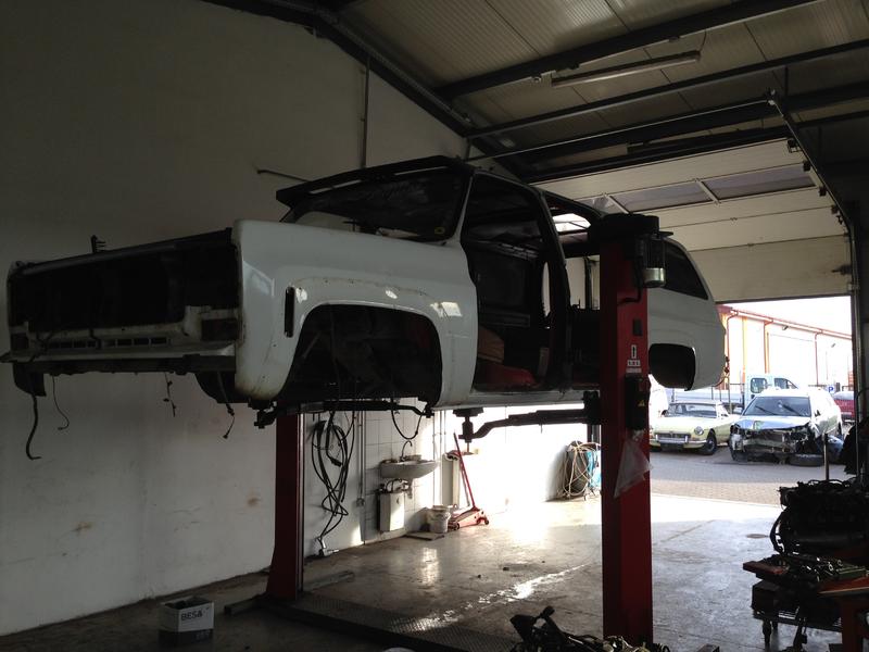

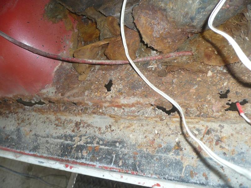

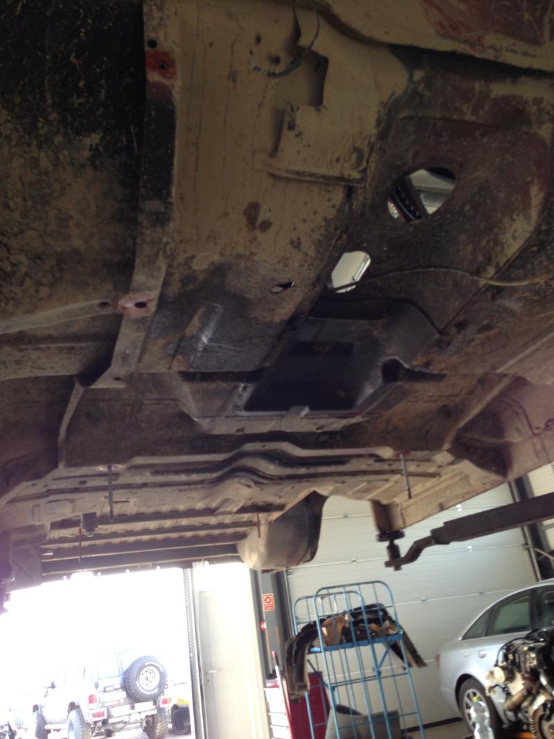

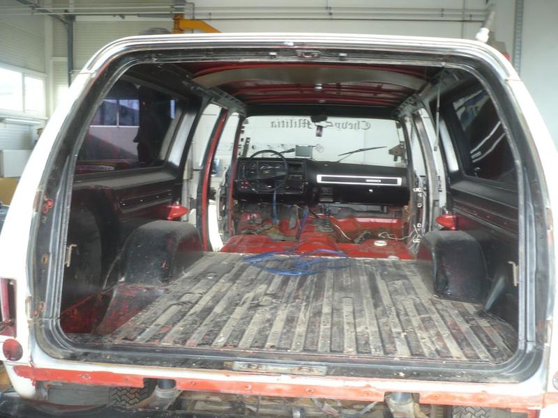

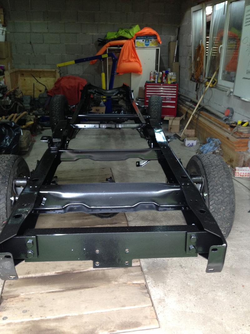

Boday welding and Painitng inside and outside, new interior

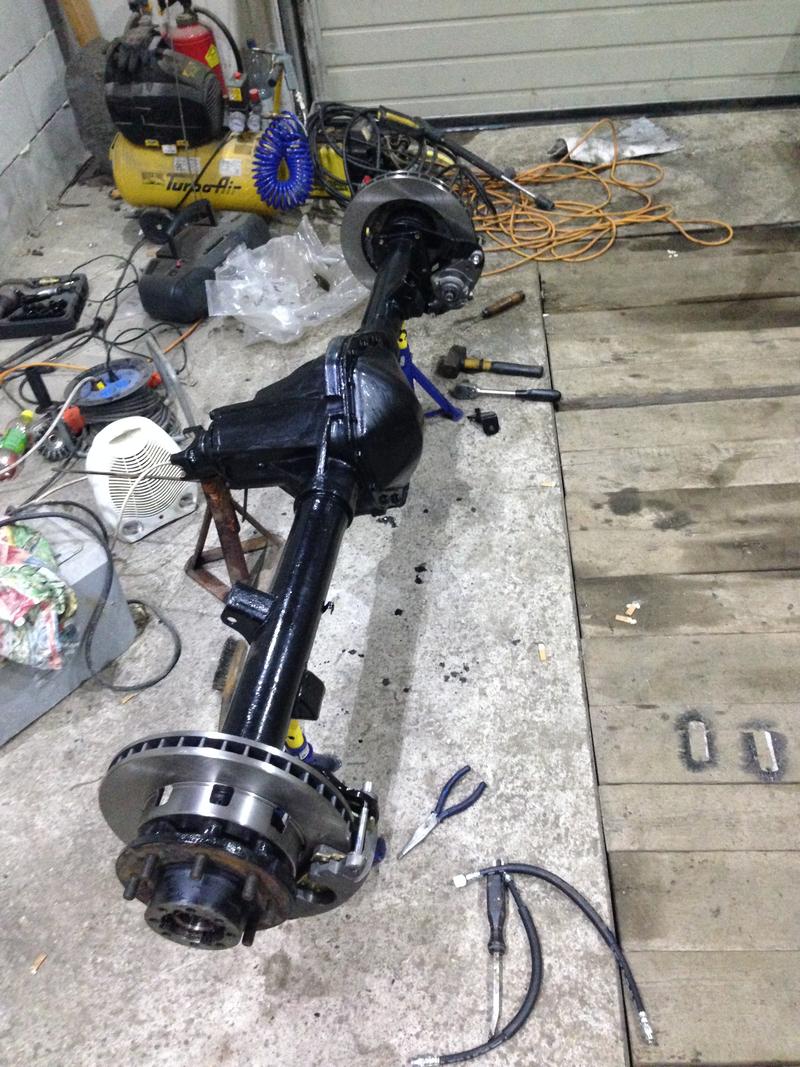

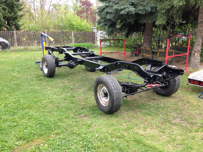

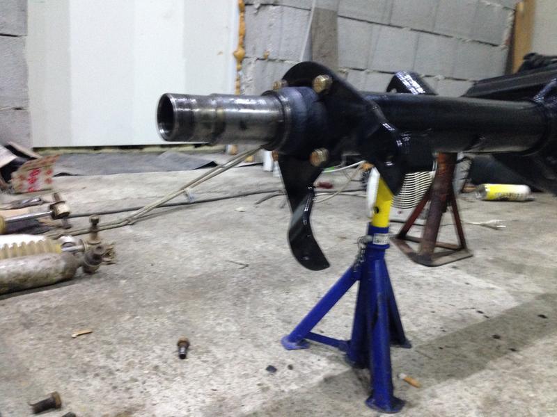

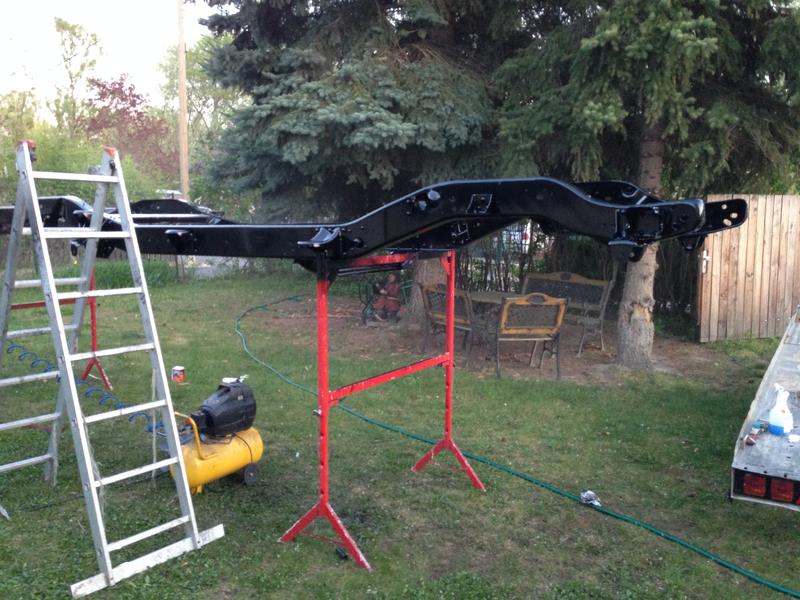

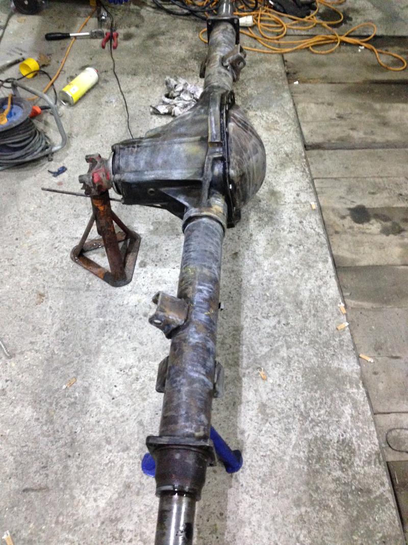

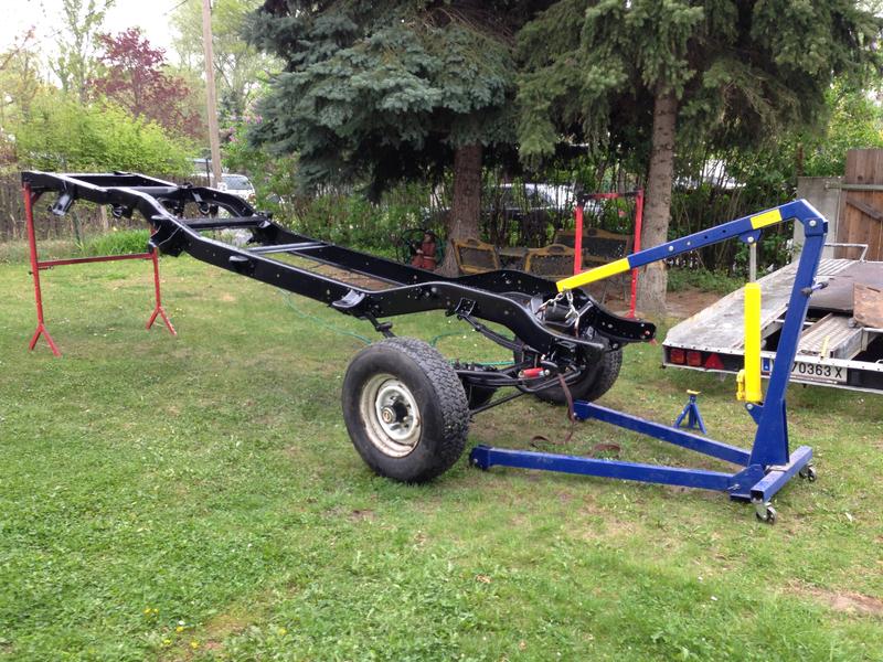

Frame and Axles get sandblasted and coated with POR15

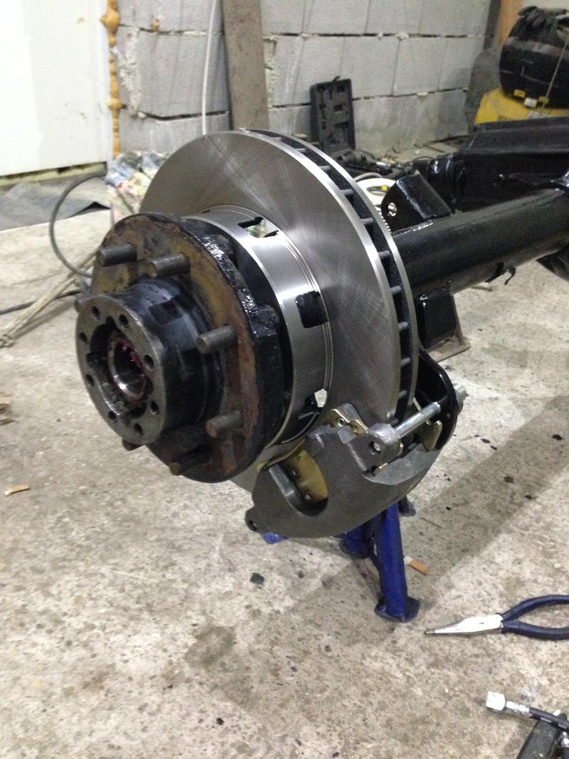

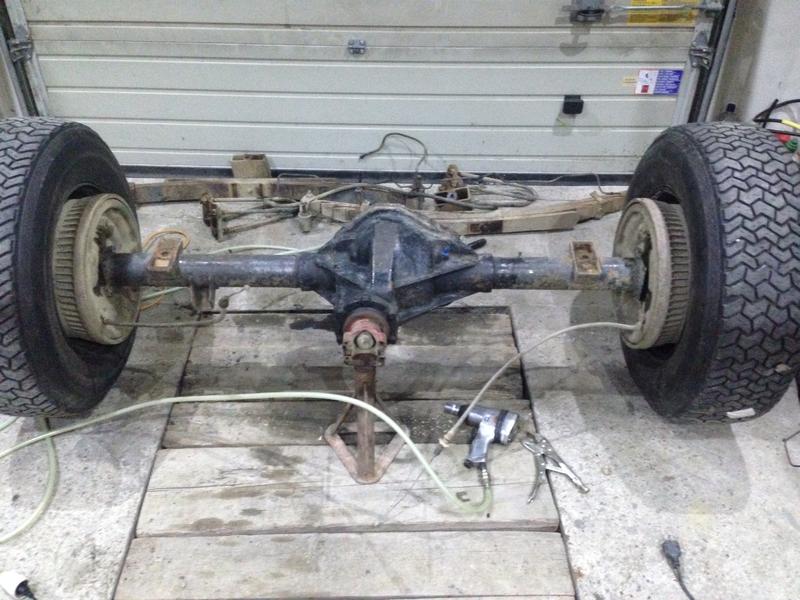

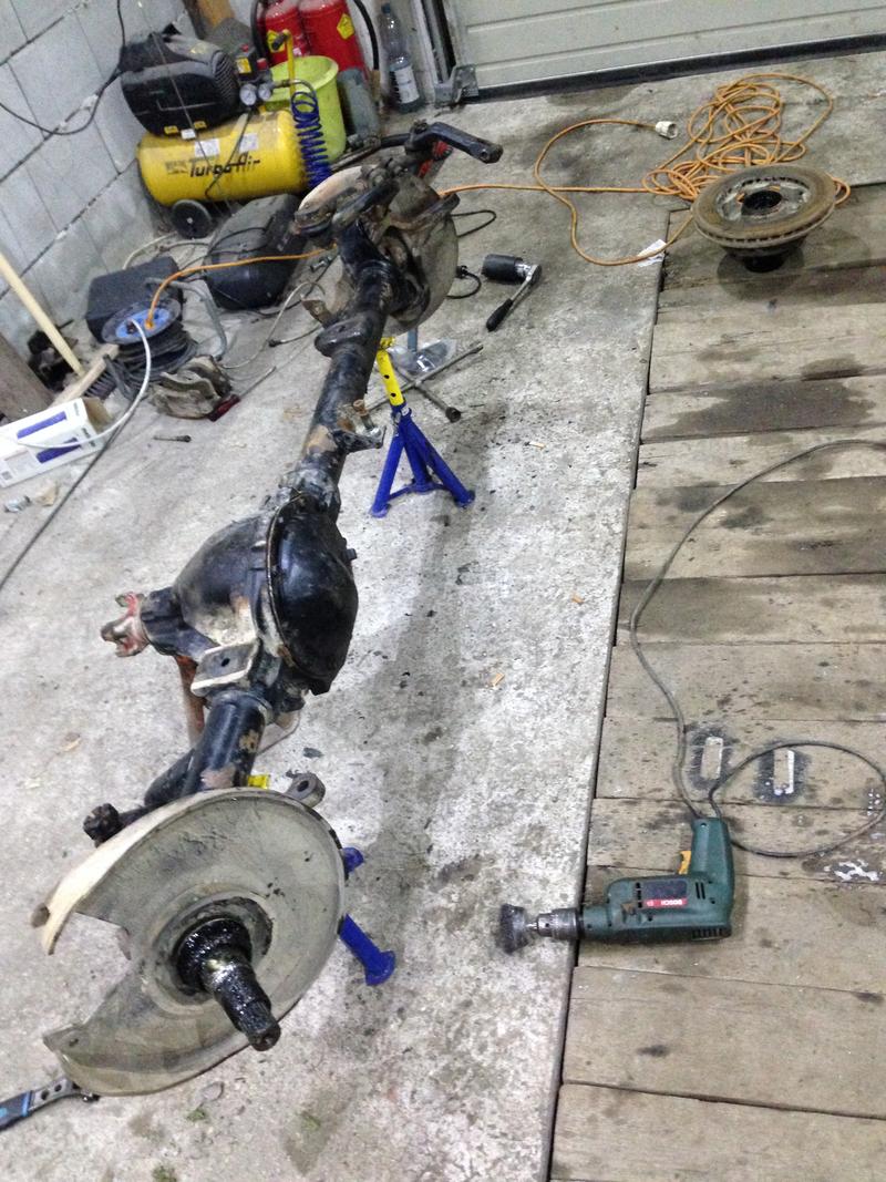

Disc Brake Conversion for Rear End

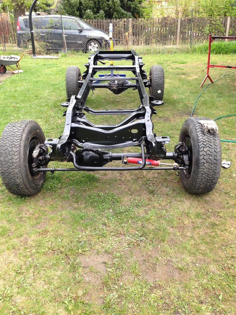

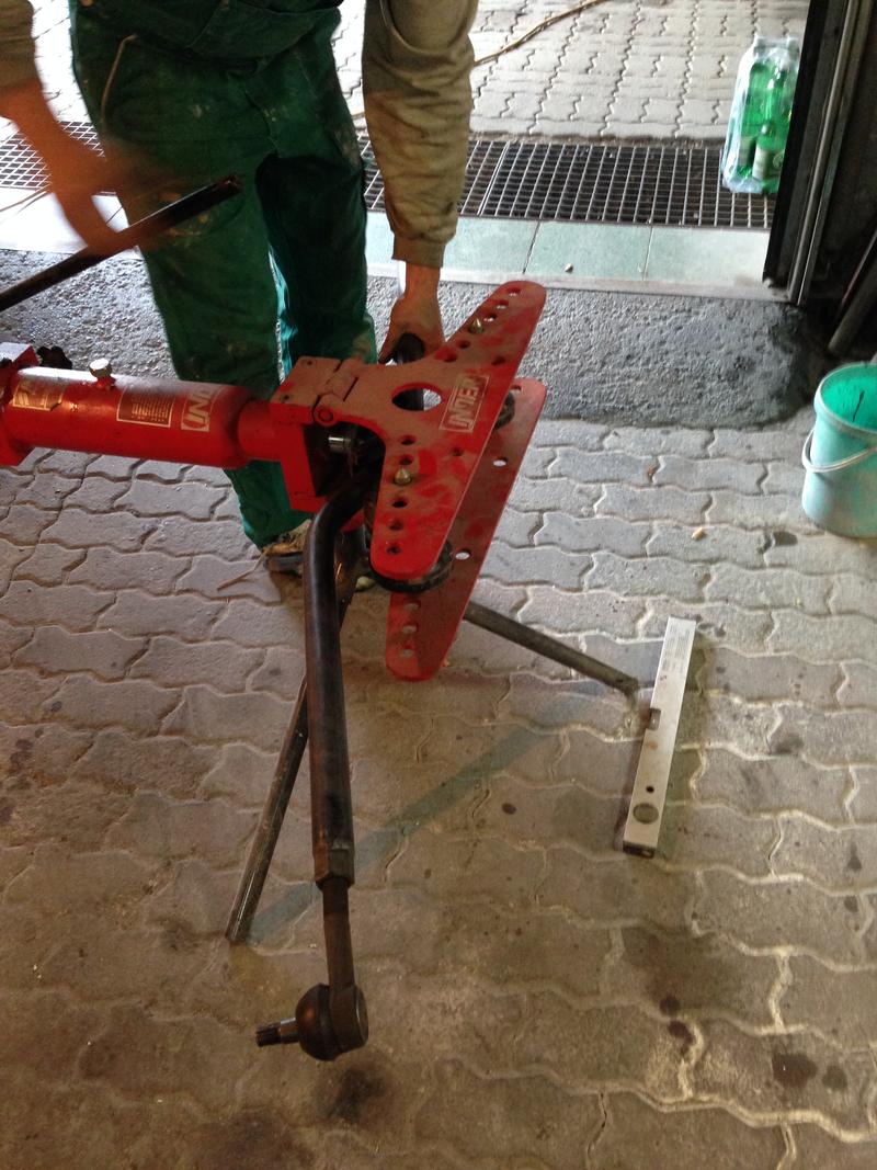

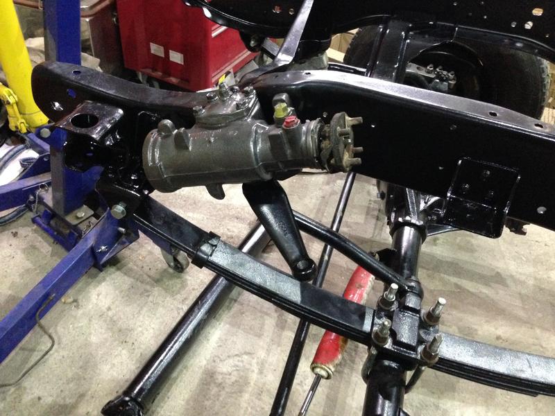

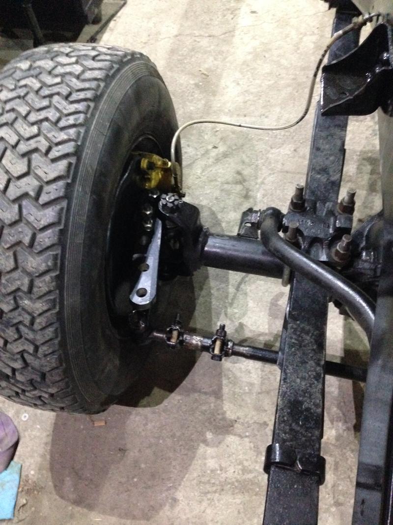

Front Axle Crossover Steering

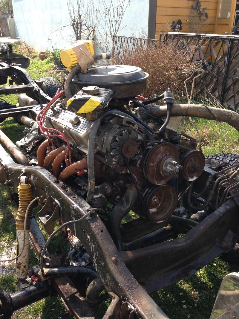

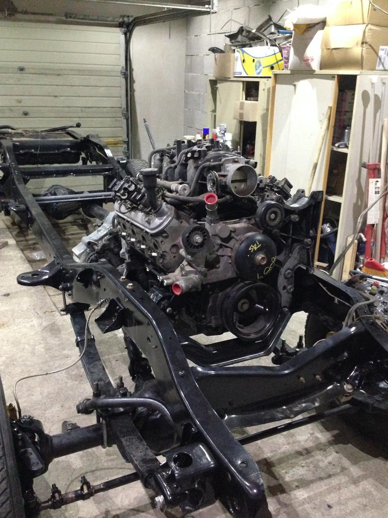

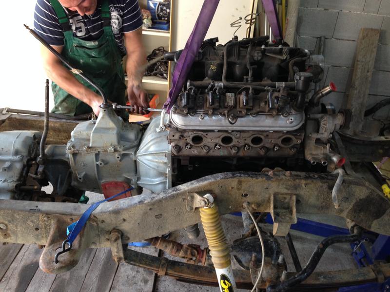

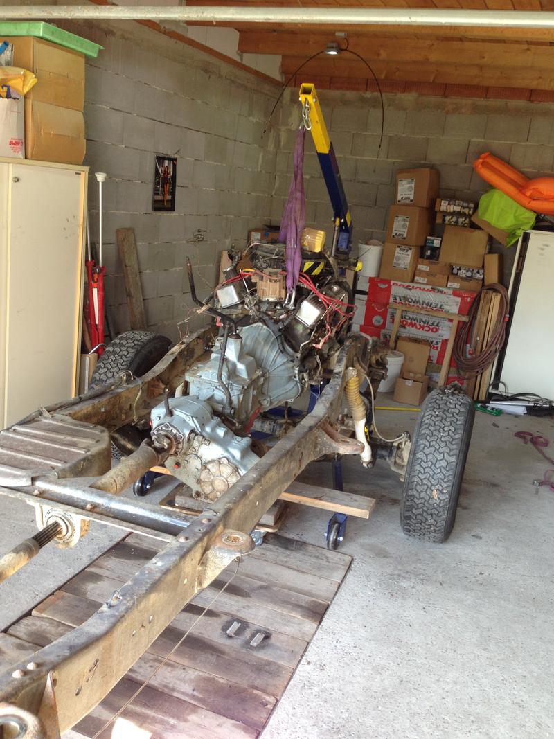

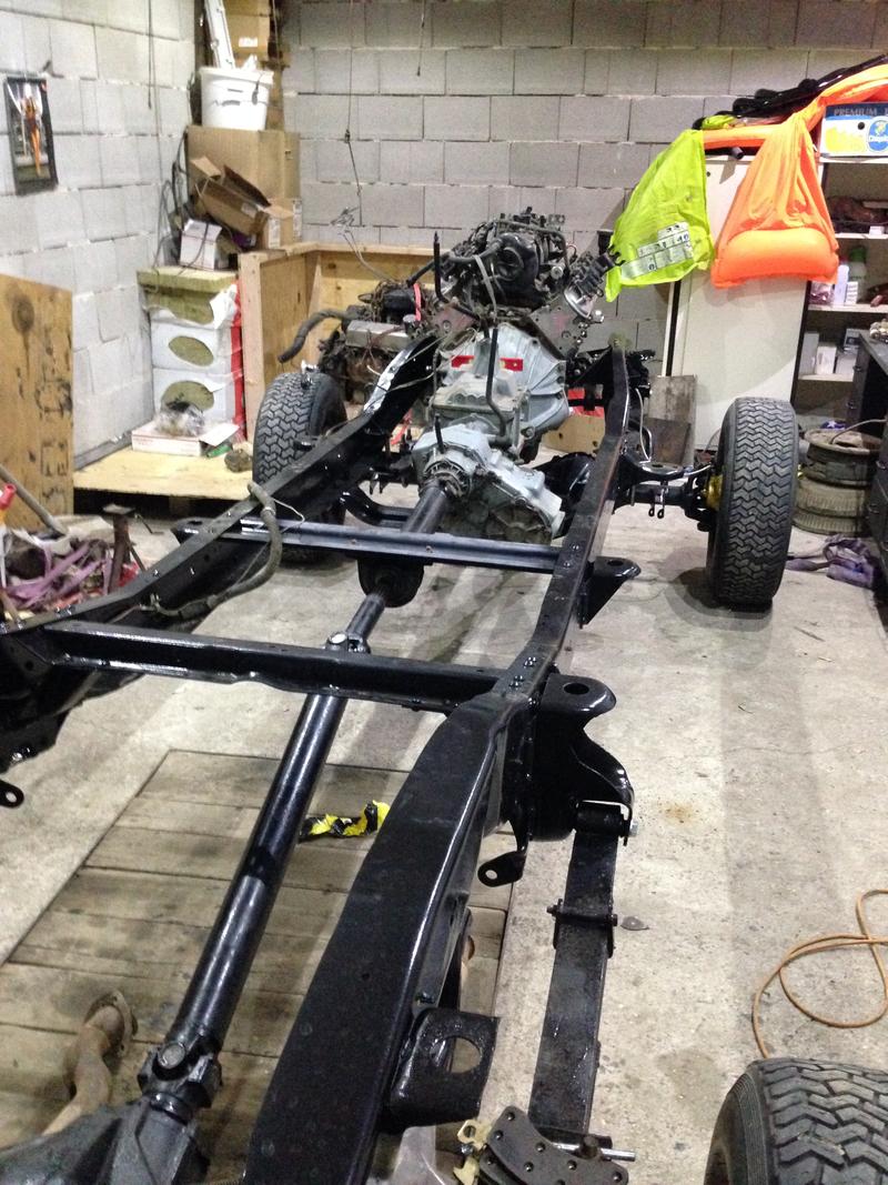

Engine Upgrade to a LQ4

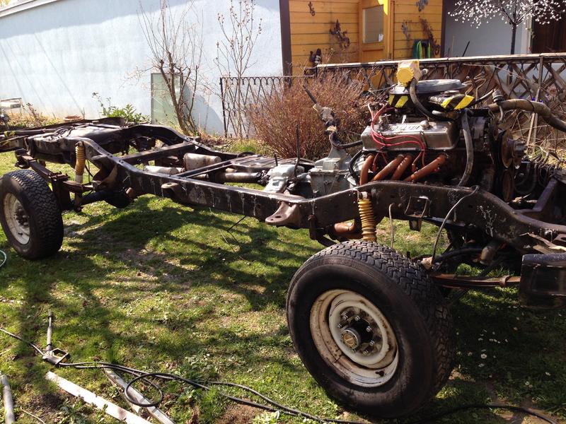

Nice work! I wish I had thatch shop space to work on my suburban.

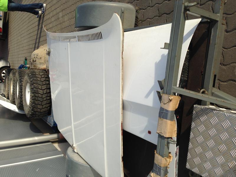

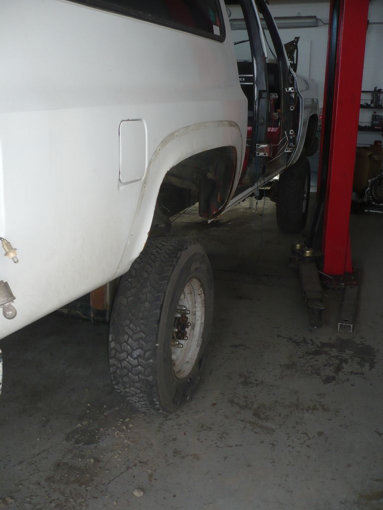

I like that you are keeping the SM465. Hopefully you are going to throw the fender flares in the garbage?
Martin

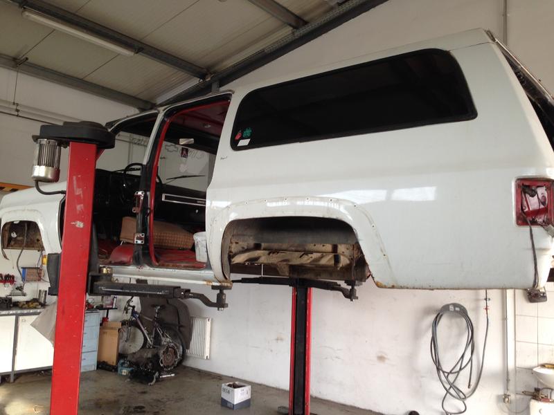

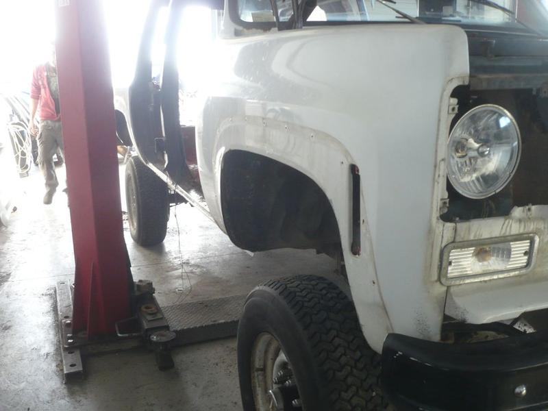

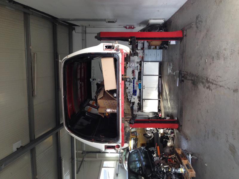

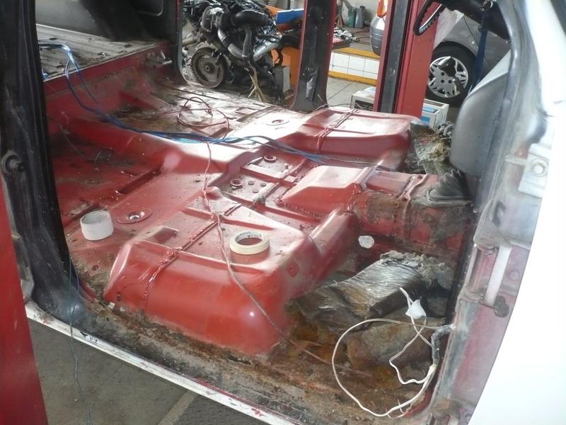

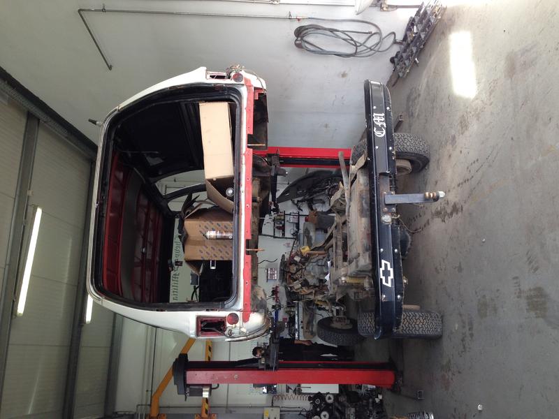

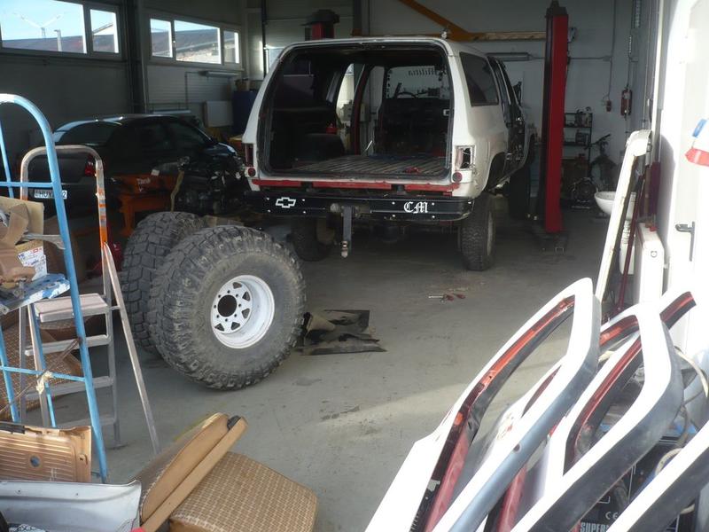

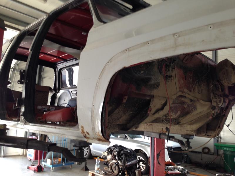

Thanks :-) my Garage is only 30 squaremeters, the photos are from the Body Shop, the will Weld and Paint the Body :-)
I have to keep the flares, otherwise the Tires will Stand out to much and thats Not legal Here in Austria:-/ Police will Take your license plate off when Tires are Not covered, but they Way bushwacker flares are Really crap, all 4 damaged at the screws, so i have to buy new ones

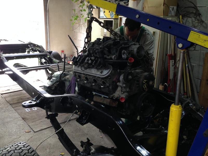

I use the original 12" clutch and the flywheel from Sachs but i have to search for the Number Code of it if You Need it
Was just curious, is the flywheel specific to the new motor, or the same as our old ones?
Its the original One from the 2006 Silverado Motor, Sachs NFW 1050
Nice work! I'd love to start with a bare frame like that! You'll need to get rid of that sway bar.
