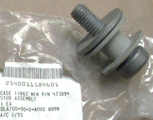

It looks like the bolts are OK, you just need new bushings. I don't know if LMC truck or the like carries them, but you can probably make some out of plastic electrical conduit or PVC pipe. Another option is to use something like heater hose. IIRC, the door striker bolts are sort of compatible, so could experiment with that if you have some. I think washers are OK instead of the shoulders on the stock bushings. I've been running with conduit in there for years.
Look at this: http://www.ebay.com/itm/GM-CHEVY-PI...ash=item4b11cc436e:g:zGMAAOSwB-1YoEV6&vxp=mtr
