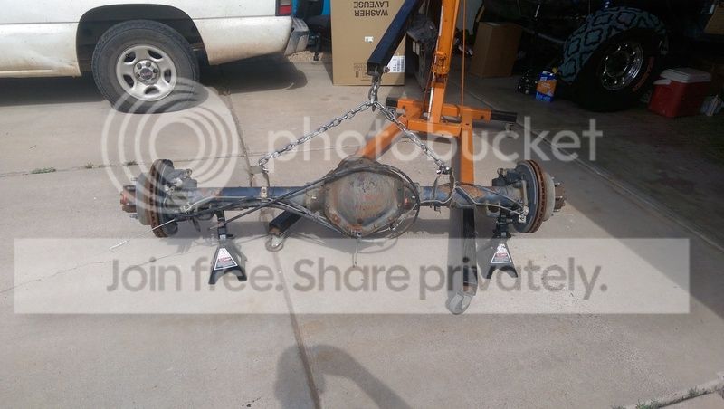

Was non eventful, sketchy but it worked.
That way looks much easier.
